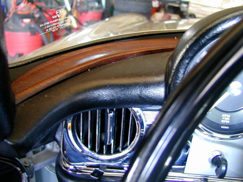

Here's a photo of the wood that is in my former SL, now owned by Craig DeVine:
Download Attachment: wood.jpg
81.4 KB
It was untouched/original and exactly as Joe described it -- dark, satin finish, and with a slight grain on the surface.

Thanks Douglas & Joe!
Nice picture, and this really helps!
This wood color looks nice on your former cars interior color and would look nice on other interior colors.

The picture of Dougs wood looks very similar to the wood in my 230SL, although mine is lighter, but the finish and description is the same, satin with visible grain !
My unrestored hardtop is the same, just less faded !
I have seen plenty of cars, usually later models with very dark, highly polished wood, which actually looks plastic. Not very attractive and obviously as Joe said its the way the factory now make it !

Yes your photo pegs it exactly. This is the original finish.
