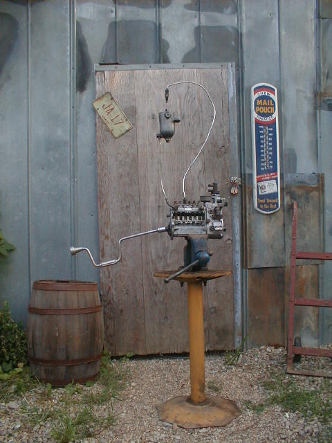

Cees and Merrill,
Here is a photo of another, more technologically advanced injector tester:   ;)
http://www.sl113.org/forums/uploaded/ja17/200582201223_Blacklick%20Injection%20Pump%20Test%20Bench.JPG
Courtesy of Joe A!
-David Pease
