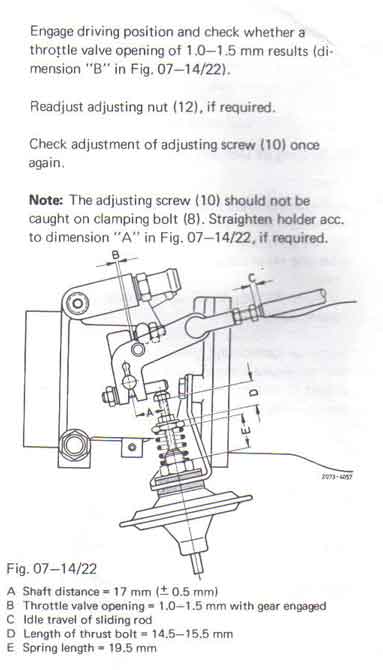

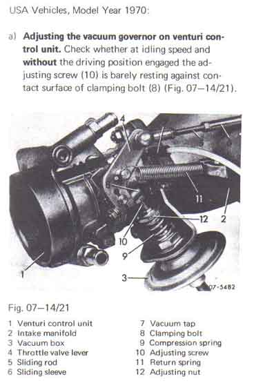

I would like to bring this topic up again to the group...
Previously, I followed the posts (and the BBB) and set all of my linkages as outlined.  I still have some trouble with my “idle in gear” rpms.  My car idles at 800 in Park & Neutral.  When I put it in gear, the rpms drop to about 400 (a rough idle).
This weekend I adjusted my vacuum governor per the instructions in the BBB.  When the car is running (with the engine running, the vacuum governor pulls inwards...) and in Neutral, the stop screw on the vacuum governor just rests below the small rod for the throttle plate (plate is fully closed at this point).  Using the assistance of my son, he put the car in gear, then in Neutral, then turned the car off, etc…  We did this many times as I had to adjust the nut on the vacuum governor that controls the spring, extending the spring out each time (also adjusting the small screw that resides on top of the spring, inwards to compensate).  The goal, per the BBB (I think?), is to have the vacuum governor slightly push up on the throttle plate and open it when you put the car in gear (I think I am understanding this???.  The BBB shows a gap of between 1.0mm and 1.5mm between the throttle plate stop screw and the small rod that opens the throttle plate when the car is in gear (?).
Anyway, now I still have the same problem, idle is too low when in gear….  Also, with the car turned off, and when I disconnect the throttle linkage rod, the spring on the vacuum governor forces throttle plate wide open…?  Before I started this adjustment, having followed the web posts, when I disconnected the linkage rod, the vacuum governor spring did not force the throttle plate open.  The spring simply remained compressed and the throttle plate remained fully closed and against the stop screw.
Is this the way it is supposed to work?  Any advice on how to correctly adjust the vacuum governor?  Also note: my CCS only activates when I turn on the air.  Otherwise, it doesn’t move forward when I put the car in gear…  The BBB states something about later cars and the ccs being only for air?
Thanks all!

« Reply #10 on: December 20, 2004, 17:21:52 »
Bob - it sounds like your problem may be in the wiring of the CSS - AFAIK it should be activated by the transmission being put in gear (forward or reverse) and not only by the airconditioning being turned on. Perhaps someone can verify/corroborate this on a US model with the vacuum governor?
If I am right, then your culprit should be in the wiring that activates the CSS, rather than the vacuum governor setup.

« Reply #11 on: December 20, 2004, 17:33:24 »
Here are some diagrams that describe how I adjusted my vacuum gov.
Download Attachment: vacuum-gov1.jpg
20.5 KB
Download Attachment: vacuum-gov2.jpg
21.39 KB

  • Posts: 4956
Re: another linkage question
« Reply #12 on: December 20, 2004, 18:36:58 »
Thanks for the pics.  I don't have one of these on my car and didn't know they existed!  I guess the CSS (Constant Speed Solenoid) on my car adjusts both fuel and air while this device controls only air.  Looks interesting, yet complicated.
