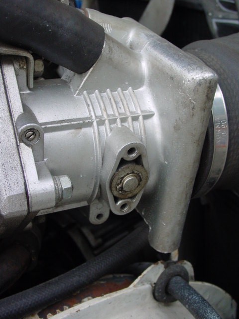

Here's the photo of the switch on the firewall. The bolt is what I had to do to fix mine, the usually is a bolt there, but it looks different, much skinnier:
Download Attachment: firewall.JPG
65.89 KB
And here's a photo of the throttle (venturi) body, where the switch is on by far the most cars. You can see the two bolt holes where the switch is attached to the throttle body:
Download Attachment: venturi.JPG
82.71 KB

Ref: Cees's picture of the venturi:
On manual transmission cars where no microswitch is used on the venturi, should there be a blank cover - using the two bolt holes?
My 280 (manual transmission)venturi looks like the one in Cees's picture but the area is cleaner than the rest of the venturi and it seems like something is missing???
'Kloines Scheisserle'
  • Posts: 5874
Re: kickdown vs. micro switch
« Reply #20 on: August 22, 2003, 14:49:27 »
Naj - I have not seen a cover on a venturi without the switch installed. Don't think there should be such a cover. What exactly do you mean by "the area is cleaner than the rest of the venturi and it seems like something is missing?"
