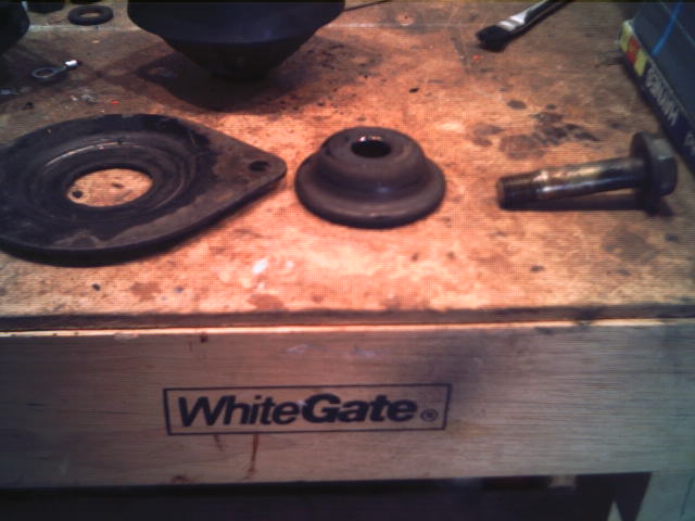

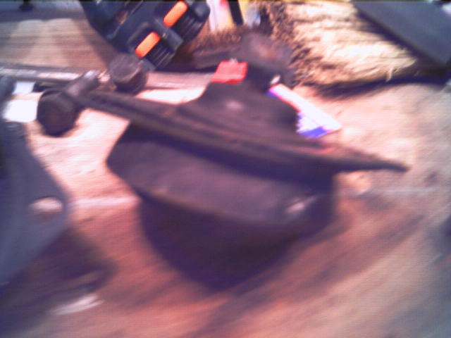

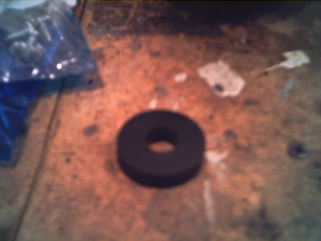

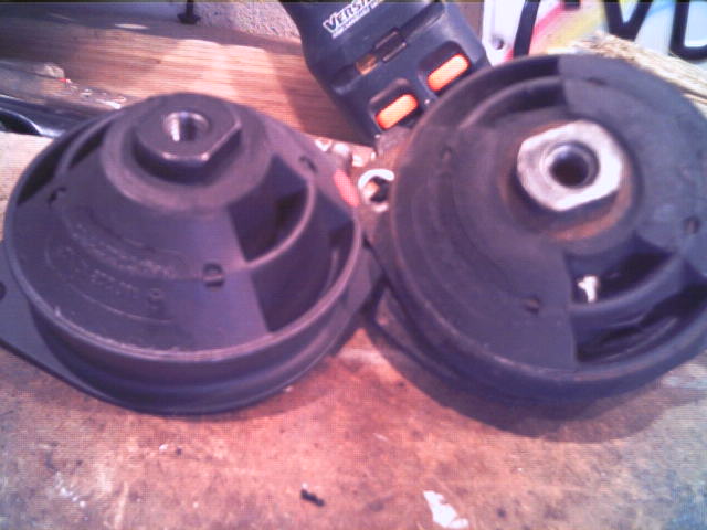

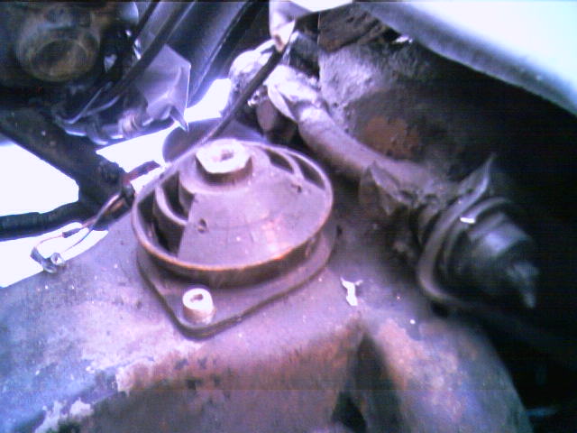

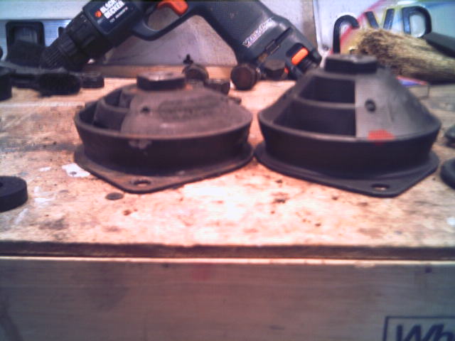

well I thought I was going to be able to answer the questions regarding the motor mounts for a 66 230 today.
when I pulled the old mounts from my car, I did not have a rubber washer, lock nut or threaded bolt.  I did  have a metal plate, large rubber bushing and a bolt that was threaded on the end.
I installed the new mounts using the old hardware the way they came out and e-mailed gernold at sl tech to find out if I can leave it as is or not.

« Reply #8 on: February 03, 2007, 16:25:51 »
Well, after skimming this post again, and going to the sls web site, I guess I have the late style mount.
I will order a rubber bushing from k&K monday.

Re: Motor/Engine mounts
« Reply #11 on: February 04, 2007, 12:36:03 »
Matt,
in your old and new pic, I think the new motor mount is incorrect.  It might be the rear motor mount that goes at the rear of the transmission?  When I replaced my motor mounts, the new ones looked much like your old one, not very tall.
merrill
  • Posts: 1389
« Reply #12 on: February 04, 2007, 19:17:07 »
George,
well, the old mount in the photo, was the bad one, the other one was just about the same height as the new one.  maybe half as short.
The mounts came in a MB kit in an mb box.  2 mounts, 2 rubber washers, 4 allen bolts and lock washers.
I thinks I just had one mount that was collapsed.

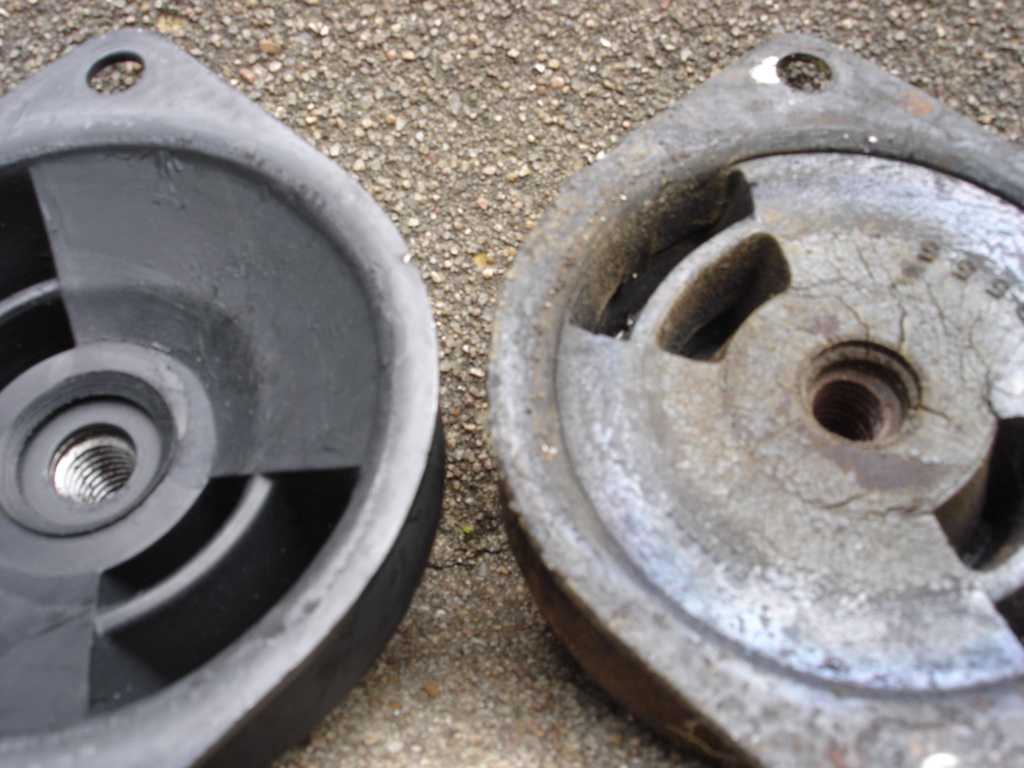

« Reply #13 on: April 20, 2007, 01:34:06 »
While I'm doing some other work in the engine bay, I decided to replace my motor mounts. I thought I'd post some pictures comparing the old mounts to the new ones (since people are always wondering what to look for if their mounts need to be replaced).
http://www.sl113.org/forums/uploaded/Waqas/200742033631_engine-mounts-compared-1-small.jpg
http://www.sl113.org/forums/uploaded/Waqas/20074203375_engine-mounts-compared-2-small.jpg
WAQAS in Austin, Texas
« Last Edit: April 20, 2007, 01:37:55 by waqas »
« Reply #14 on: April 20, 2007, 01:42:46 »
Forgot to mention-- the stop-plates were missing when I removed the old mounts. It looks like there are many shops that simply throw away the attached plates/bolts along with the old mount, while replacing the mounts, not knowing their true purpose.
Incidentally, I was discussing the plates with a fellow car nut (from Munich no less), and he mentioned that these stop-plates may also have been placed there for preventing the engine from flying off during an accident. Ahhh... good old German engineering.... must protect precious engine... but seat-belts for the human... who needs 'em!
« Last Edit: April 20, 2007, 09:08:26 by waqas »
