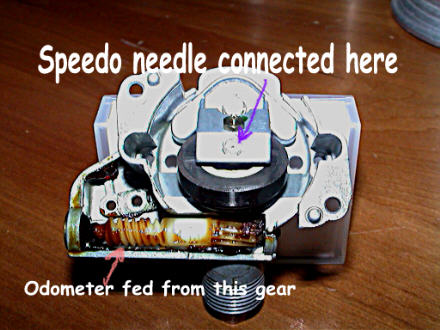

Just starting to look at speedo calibration.  Several BMW/Porshe sites talk about VDO odometer problems and repairs.  One has a picture of the magnet and gearing.  I have a 280SEL speedo apart and the assembly is the same with the exception of the lower worm gear.  Here is a pic of what I'm looking at.  How is calibration or adjustment accomplished.  Gear changes?
Seems to me that the white gear at the bottom is important to accuracy because it appears to drive the speedo needle and odometer.  These should be in sync to get accurate readings.  Comments?
Download Attachment: Speedo.jpg
41.74 KB

Jeff the gears in the speedo head only effect the odometer reading.
The magnet spins inside a steel disc that is attached to a hairspring and the indicator needle, as the magnet spins the disk tries to follow the rotation of the magnet but is held back by the spring, so the only internal components that are adjustable would be the spring tension and the relative position between the indicator and the spring. More tension, lower readings--Less tension, higher readings.
Al

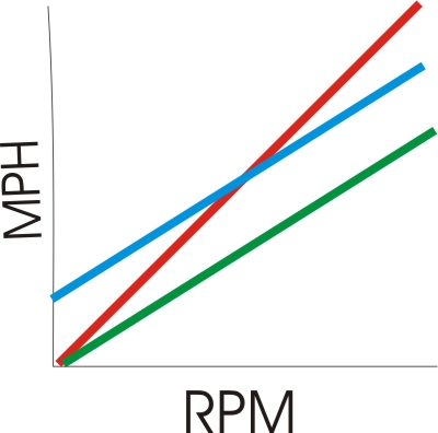

Jeff in reply to your off forum question, I am not sure how difficult it would be to move the indicator to a different position on the shaft, I have never tried it.
What would happen if one were to do this? I will have to use a graph to explain.
the RPM scale represents the propeller shaft speed.
MPH scale, self explanitory
The red line represents the actual vehicle speed with the new axle ratio.
The green line, the speed indicated on the unrecalibrated speedo head.
In your message you asked what would happen if at say 60 mph you were to move the needle on the shaft to a corrected speed you calculated (lets say 67mph) to match your new axle ratio.
This results would be represented by the blue line with that calculated (67mph) being the point where it crosses the Red.
This graph is for illustration purposes only, and is exagerated to show the results more clearly.
It would take a combination of adusting the spring tension and needle position to make the speedo respond accuratly through the entire range.
and of course the odometer gears would need to be changed to make the mileage read accuratly.
I hope this expalains things more clearly.

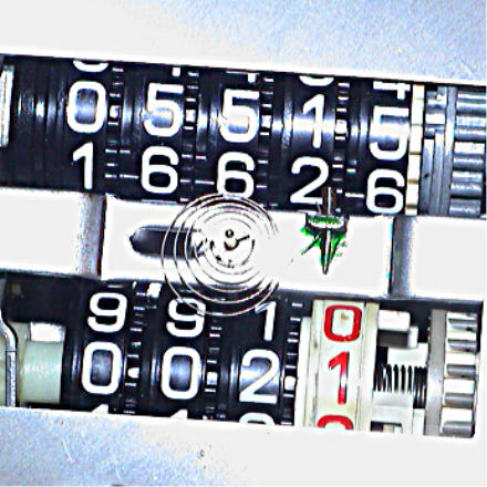

For those interested here are some pics of the inside of a 1972 VDO 280SE 4.5 speedometer.  Similar in many ways to our SL speedos.
Download Attachment: hair spring.jpg
55.6 KB
Download Attachment: magnetic cup.jpg
34.22 KB

Another source of a change in friction within speedo are at the bearings for the gears that drive the odometer... since those are also driven by the shaft's rotation, but other than create a constant drag on the shaft, this source of friction won't cause the speedo to have an offset or slope change with shaft rpm..... other than a momentary and temporary (less than a fraction of a second) lag .... & then only when initially accelerating from a full or near full stop.
The other variable that can effect calibration is the location or attachment of the helical spring to it's fixed end points... and if either of them move it changes the offset of the speed indicated.. i.e. the speed is always indicated to be Actual +/- x... x is constant at all speeds, since the spring constant hasn't changed... just the position of the position of the spring's zero force point.
The magnetic force on the disk can only change if the location (distance) of the magnet to the disk changes, and I don't know whether there are wearing members that will increase or decrease the distance over time and wear. However, if this occurs then the relation of the magnetic forces applied to the disk changes, so that the helical spring's countering force relation to the magnetic force changes, and this will cause a change in both the slope AND offset of the speed vs shaft rpm.  Assumedly, if this occurs, the distance between the magnet and disk will increase, decreasing the magnetic force, thus making the spring constant of the helical spring relatively too large... reducing the indicated speed vs that actual speed at an increasing rate... i.e. the higher the speed the lower the indicated speed relative to the actual.  If the distance decreases the converse ocurrs.
You can't change the spring constant of the spring without changing the spring's length, width, or thickness between the fixed ends of the spring.... shortening the length increases the spring constant, which adds to the countering force on the disk, and drops the slope of the indicated vs actual speed... lower indicated speed than actual with an increasing error as speed increases.  Increasing the length of the helical spring between it's fixed ends does the reverse.
Generally speaking, I'd expect the frictional and shaft/bearing wear points to be the cause of most error in W113's speedo's.  ...i.e. friction, therefore pure offsets, but not a change in slope.  Unless the spring's fixed end points have changed so that it's changed the length of the spring, the spring constant won't change.  ... so other than that I can't think of any means by which the slope of the relation would change unless the distance between magnet and disk have changed.
Could the magnet material itself lose some of it's magnetism over time?  Possibly, if it's not a natural magnetetic material.  If so, it would change the magnetic force acting on the disk, so that the spring's countering force would no longer have the same relationship as the magnitic force increased with increasing rpm....i.e. it would change the slope of the relationship (magnet rpm to indicated speed), as well as the offset between them.
There is another cause for change in indicated vs actual speed that has nothing to do with the speedo itself, rather the shaft connected to it.  The shaft runs in a tube...and thus has frictional forces while turning in the tube.  Those frictional forces restrict the ability of the shaft to rotate in the tube and retard the shaft for a period of time... small sub-second periods... as the torsion in the shaft winds up under frictional forces in the tube, the speed shaft is retarded in it's rotation momentarily... and when it winds up enough, the force to unwind overcomes the friction in the tube, and it' unwinds ... speeding up it's rotation relative to what it should be, and indicating a faster speed than actual.  What you really see on the speedo dial is a wobbly speed indicator... bouncing back and forth around the actual speed.  Lubricating the shaft in the tube with graphite will solve that symptom.... though it indicates a wear problem has occurred within the tube, so the graphite solution may not do much for the symptom if wear is extensive (and / or wear debris is extensive)... it will reduce the wobble, but not eliminate it, or if it eliminates it, it may not do so for long... a year's worth of intermittant driving, perhaps.
A speedo calibration shop knows the design relationship beteen spin speed of the magnet and indicated speed on the speedo dial.... either because they have the spec's or because they've evaluated a lot of "in calibration" speedo's over time.  They spin the magnet with known rpm, and mesure the relationship.  If the relationship shows an offset exists (after cleaning and / or replacing  bearing surfaces), there has to be a feature in the speedo that let's them change the location of one of the fixed end-points on the spring attached to the disk... which either adds or subtracts the force beign applied by the spring to the disk... depending on how much offset was indicated.
If the slope's off, frankly, I'm not sure what a speedo shop can do to effect calibration unless there's an adjustment feature in the design that let's them increase or decrease the fixed length of the spring... effectively shorten or lengthen it.... maybe up to 5% - 10%?.
Normally, cleaning and/or replacing the worn or dirty bearing surfaces, with and adding a few drops of the correct weight lubricant should result in an almost immediate "recalibration" without changing anything else.  Since I'm not familiar with design details, I can't describe what other adjustments there may be designed into the device for initial setting and calibration.

This is a very common problem on the mechanical VDO speedometers.
The alloy metal disc that drives the rotating digits (next to the 1's wheel)it is press fit onto the shaft that the numbers are mounted on. It will work loose from the shaft and the numbers will not advance any more.
Al
