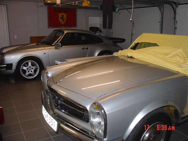

Winter is approaching  :x  and our Pagoda is preparing to hibernate. Before winter I always wax our cars and wonder what kind of wax/polish do you use? I have been tempted to buy the expensive Zymöl wax, but has so far been doing fine with regular Turtle Wax Polish and Sealant.
Have a nice winter
Finn Lundorf 8)
1964 230SL Euro 4-speed silver metallic with black leather interior
1988 230 E silver metallic
1985 Porsche 911 Carrrera 3.2 silver metallic
Download Attachment: DSC03135.JPG
50.71 KB
