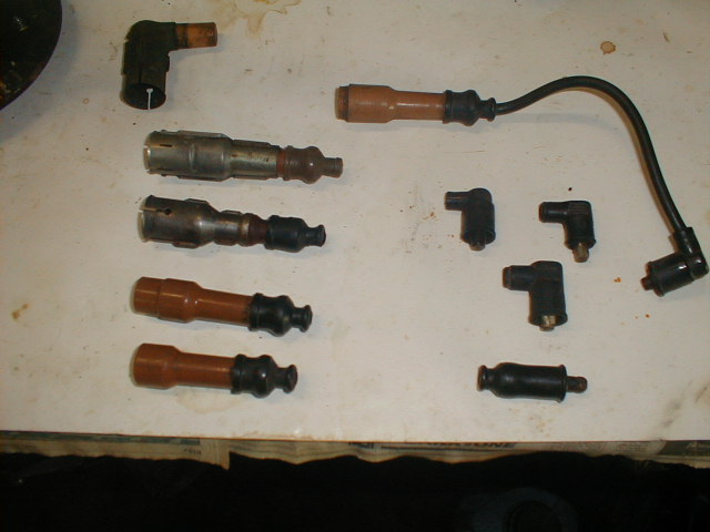

Here are some original version spark plug connectors,
Download Attachment: spark plug wires.JPG
54.92 KB
The right angle version was used only on #1 cylinder of Mercedes sedan carbureted engines.

Hello Joe A,
Are the spark plug wires/connectors supposed to have the small rubber boots on both ends?
My 250sl has them only on the distributor end.
  • Posts: 7507
Re: spark plug question
« Reply #8 on: October 24, 2006, 05:15:23 »
Hello Bob,
I can't say for sure that all years had the rubber boots on the plastic spark plug connectors. The late BBB (07-12/1) does show the rubber boots on the plastic spark plug connectors.

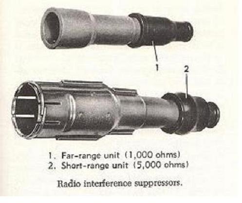

Maybe  modern replacement sets have those specs, however the originals were 5,000 ohm for the  metal shielded spark plug connectors and 1,000 ohms for the plastic spark plug connectors. Maybe new replacement sets are stainless wire but originals spark plug wires were definately coated solid stranded copper wire.
Download Attachment: wire ends.jpg
61.53 KB
A page from Mercedes Benz Technical Training Manual also gives these specifications in Feb, 1967
Supressed Spark Plugs 5,000 ohms
Original Coil 1.7 to 2.1 primary resistance
condensor capacity 0.23 to 0.32 MCDF
distributor rotor 5,000 ohm
unshielded spark plug connectors 1,000 ohms
metal shielded spark plug connectors 5,000 ohms
coil wire end at coil 1,000 ohms
coil wire end at distributor  1,000 ohms
« Last Edit: October 26, 2006, 00:49:49 by ja17 »

  • Posts: 1385
« Reply #23 on: November 06, 2006, 20:36:58 »
Michael,
so, even if I had the aftermarket set, should the wire & connector resistance for the #1 cylinder still be higher than the rest?
the #1 connector is at a 90 degree angle while the others are straight.  Another difference is the #1 connector is red and there is a scrw on the connector that the wire goes onto.
the rest seem to be molded ends and with the exception of the metal cover are black in color
Matt

  • Posts: 7507
« Reply #24 on: November 06, 2006, 23:18:11 »
Hello Matt,
Yes I agree with Michael, that coil wire sounds way to high. Replace it or its ends. Make sure your new  coil wire has metal wire and not carbon cores.
The right angle cable end on #1 cyl. is  original on Mercedes carbureted sedan engines. All the fuel injected engines of the era and all W113 engines had six straight connectors.
Normally the wires should be close as far as resistance. It looks like your #1 wire is not a match to the rest of the set.
Hopefully this will solve the miss. If not it will be one more thing put right and one less potential problem on your list!
