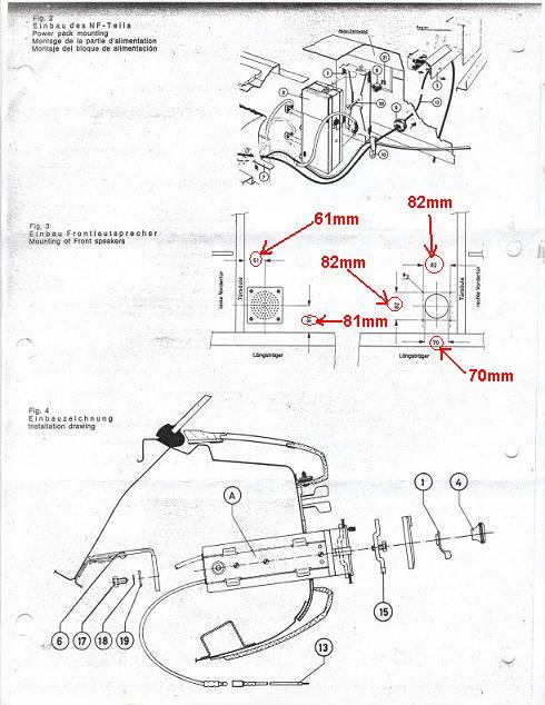

Hello Nik,
Here are scans of the Becker information.

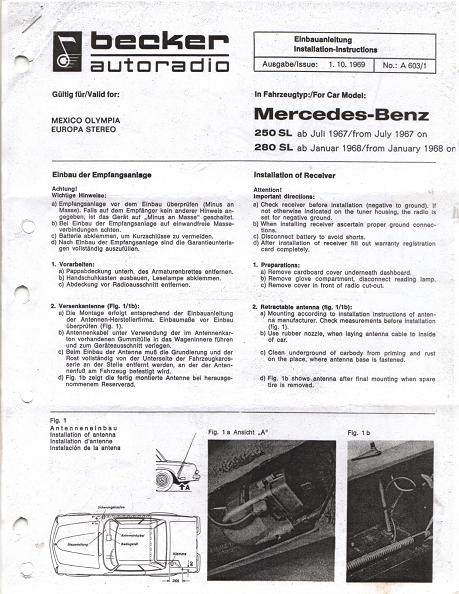

Download Attachment: Stereo1.jpg
76.58 KB
The above page shows an unusual rear mounting configuration for an electric antenna. I have never seen a pagoda with and antenna located on the rear quarter.
Download Attachment: stereo2.3.JPG
79.87 KB
This mounting layout is a little difficult to see. However all the information is here.
The top diagram shows the mounting of the separate power pack, some wiring and the separate fuse box.
The centerline of the speaker is 61mm from the "tuirsaule" and 81mm from the top of the "lanstrager".
Information for the speaker hole and mounting holes is also given in the other diagram. The speaker hole diameter is 70mm and the holes for the mounting screws are arranged in a square layout of 82mm between screws. 3mm diameter screws are specified.
The bottom diagram shows the configuration of the original radio rear support bracket.

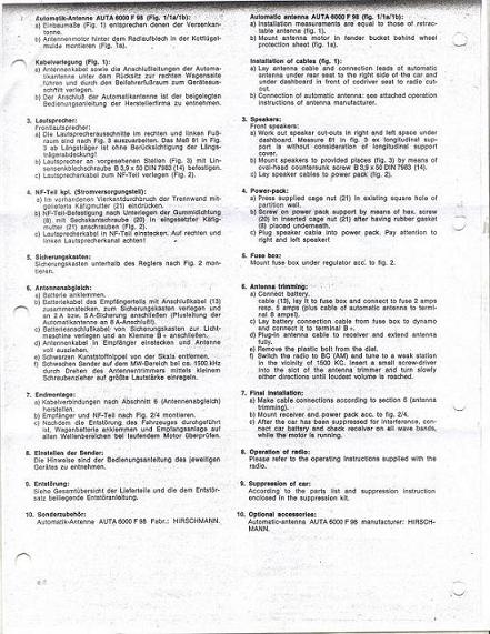

Download Attachment: stereo3.1.JPG
75.54 KB
Download Attachment: stereo4.1.JPG
80.13 KB
This parts list is very complete and includes parts numbers for all parts and hardware including the interference suppression kit, auxilary fuse box and wiring.
