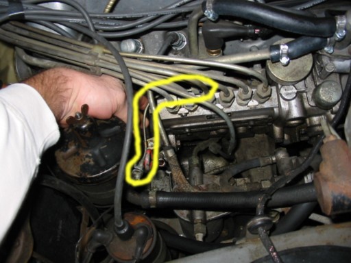

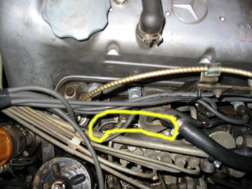

This dip stick can be hard to find, it's not on top of the pump, but on the rear of it down low.  Very hard to see from any angle.
I just looked at my pump, which is a PES6KL70/120R11, and I have three lines coming to/from it.  If you consider fuel injector pump cylinder #1 towards the front of the car, then I have:
1.  A large line, about 6mm, that went from #6 (engine side) down below the pump to the fuel filter housing.  I assume this supplies filtered fuel to the pump?
2.  A large line, about 5mm, that went from #1 (engine side) around the front of the pump, into a fuel flex line, and down to an unkown device.  I assume this returns fuel to the tank?
3.  A small line, about 1mm, that goes from #4 (engine side) and travels forward, bends down then around the front of the pump, and terminates in the engine block below the distributor area.  I would think this could supply oil, but there is only one line, so it can't be a circut.  I don't know what this is.
Pics of #3 attached

Re: Injector Pump Timing & Other Pump Info
« Reply #17 on: March 04, 2003, 10:59:18 »
The set up that Rodd describes in the last post is exactly as my car !
So which way does the oil flow ?
Maybe if one were to overfill it, this pipe would be utilised to return the oil to the engine !
