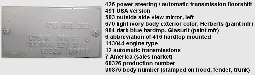

« Reply #5 on: October 20, 2006, 10:22:55 »
Here is a summary of the option codes taken from my car.
I have the photo of the plate and the associated codes deciphered.
Abbas
Download Attachment: car option codes.JPG
45.84 KB
