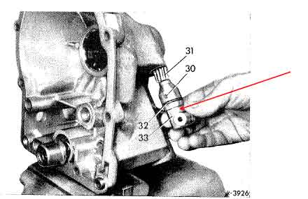

Question...  isnt the speedo cable housing a separate piece that slides into the back casing?   See attached pic.  It appears that all I need to do is to somehow replace the housing...  I wonder if I can replace the speedo cable housing w/o removing the back casing?  Looking for a short-cut...
Note: The red arrow points to where mine broke off.  The clamp part with 5mm bolt are in one piece. Broke off right where it protrudes from the casing.

Best ck with someone more familiar with that type of rear cover. It does not look like any of the ones I've seen on the MB boxes. The ones I have seen are all a one piece rear cover where this "clamping" area is not removeable as it appears here. Joe Alexander or the Dr may be able to help.

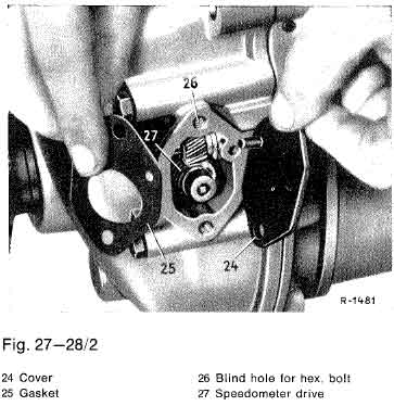

You can replace the speedometer cable clamping mechanism on your tranmission also. This can be done by removing the small cover plate (two 10mm bolts). This cover plate has a pin which locks the mechanism in place. After the two 10mm bolts and the cover is removed you can simply pull the clamping mechanism out. It has an o-ring seal.

I know exactly the plate you are referring to.  I found the section in the BBB.  See pic

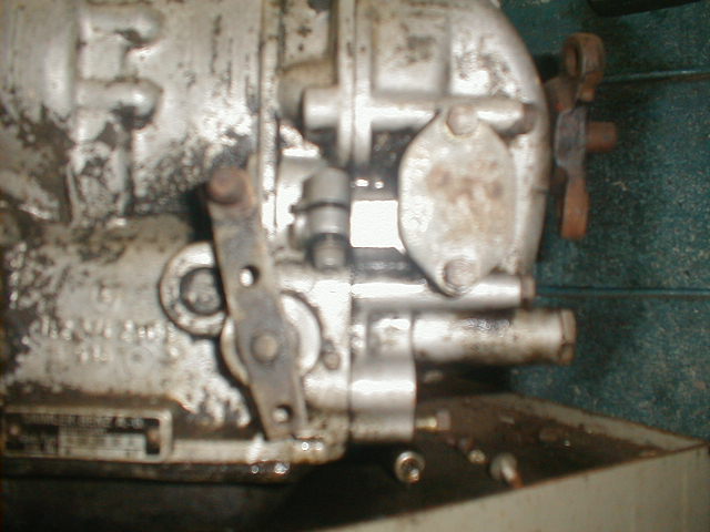

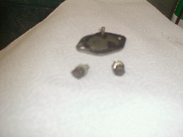

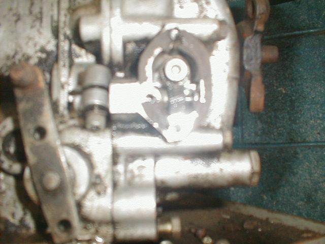

Here is some photo imformation. Excuse the out of focus, (something not right with this camera). Notice that the plate has a pin which keeps the clamping unit in place.

After the plate is removed the clamping unit simply "slides out".  There is a thin paper gasket on the plate and an O-ring seal on the clamping unit.
