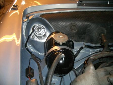

Hi - here is a picture of mine painted in march this year - after 2500 miles this summer it it still looks the same. (Black hobby enamel spraycan + grounding)
