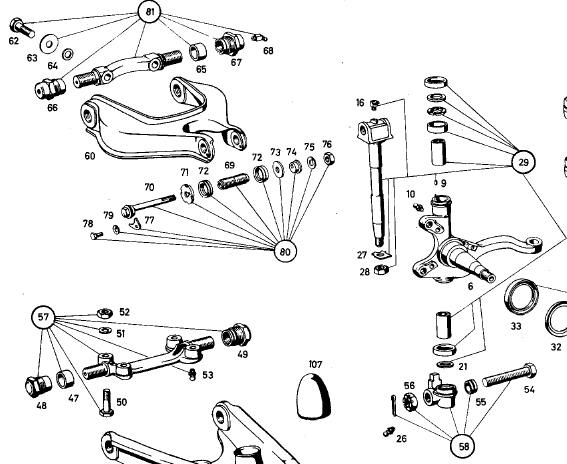

Michael ..... You can support the spring on the lower 'A' arm and remove #66 and #68 to clean them so that they will take grease.  That will get grease into the bushing but it still may still need to be replaced.
By "boot" are you referring to #55?  That should be available outside of the kit.  It is there just to keep out the dirt and you could make one from a 1/2 inch piece of hose.

I recently bought the rubber seals for my 220S, #65 and #47, which are the same, and kit 80 as well as seals #55 and #72, which are the same. I have the same problem with my zerks not taking grease. As long as bolt 70 will turn, you're in good shape, IMHO.
Also, kingpin zerk 10 needs to take grease as well, obviously.

If the boot you refer to on the lower CA is the little seal that Jim shows on his pic (what a helpful diagram!) then you can probably find a suitable rubber washer or slice of hose if you want to avoid the lower CA rebuild kit. But I think you will have some trouble getting it right, the original seal is a flexible little sucker with an "accordian" action that lets you squeeze it into place and causes it to acheive a good seal once intalled.

Rubber Seals:
On Jim's picture:
#55 is 181 333 0180
#47/65  120 333 0180
