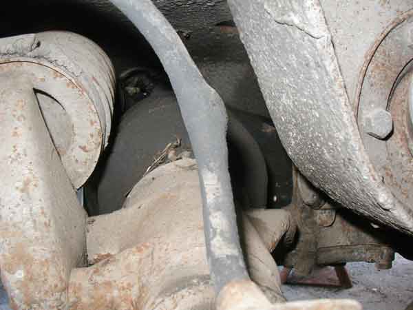

What happens with these older cars is that the rubber that is used to make the brake hoses begins to degrade. In technical terms,  the hose becomes permeable  instead of non-permeable. Then what actually happens is the inner diameter begins to get smaller and smaller as the hose material absorbs brake fluid. In the worst cases the hose will actually completely choke-off and not allow any of the brake fluid to flow back out of the caliper after the brakes have been applied. It sounds as thought that is what is happening on your car. This same thing happened to my car after I stepped on the brakes for the first time in five years.
Forget about further troubleshooting - -  I suggest you immediately order a set of new calipers and a set of front and rear hoses. You have probably already done so  - - EH?
Regards  - - and keep us informed?    Larry in CA    '66 230SL
