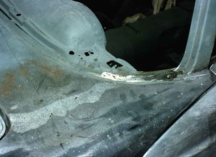

Re: Replacement fenders
« Reply #4 on: August 31, 2006, 19:43:38 »
Originally posted by waqas
Thanks Naj-- I've sent an email to Pagodenteile for more information. I actually need new sheet metal mostly around the headlights, but I imagine replacing the entire fender might make it a bit easier --avoiding having to "blend-in" much and potentially ruining what is arguably the most elegant front fender on any car.
Has anyone had much experience with lead-filling? This will be my first outing down that lane...
WAQAS in Austin, Texas
I replaced fenders and quarterpanels (and...) on my car.   The parts were ordered through MB in '93 and arrived with MB parts stickers,  but as michael accurately pointed out, that doesn't necessarily mean anything. I went with lead for seams in attempts to be faithful in the restoration. But again, not sure if that means anything with the the quality of modern materials. I would not get to hung-up on using lead.
