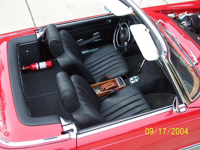

Here is a photo I found somewhere (maybe on this forum) of what is supposedly the fire extinguisher that MB optionally provided with the car.  My '66 has a small metal "clip" on the short verical section of the floor immediately below the front of the driver's seat for securing it.
http://www.sl113.com/forums/uploaded/davidapease/200692717955_FireExtinguisher.JPG
