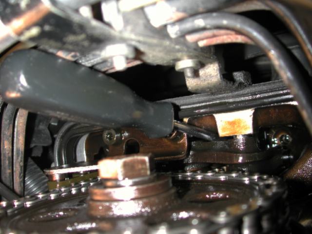

« Reply #16 on: August 30, 2006, 10:42:01 »
Hi, Bob,
Can you confirm that the bolt does come out without removing the cam sprocket and the chain tensioner arm?
After reading your post, I too decided to tackle the job this afternoon. The tensioner lever assembly is spring loaded so if you wedge a screwdriver between the head and lever, it will give you a bit of extra room to get the screw out. Mine was loose too and I used a magnet to take it out. Also used a syringe with a bit of pipe to suck the oil out of the well.
I suggest you use a non-ball end hex to tighten the bolt. I used a ball ended one with a rachet and it rounded the bolt head.
Download Attachment: Hd-Bolt16.JPG
43.52 KB
Also checked valve clearances while the cover was off.  :)
Hope this helps...

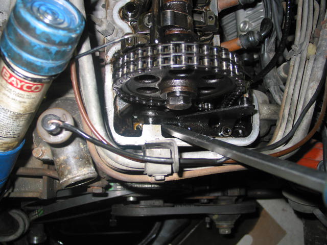

bcjm
Re: where could be the leak?
« Reply #18 on: August 31, 2006, 18:43:14 »
It worked!  I got the bolt out without removing the tensioner arm.  Once the tensioner arm is pushed using a screw driver, it provides enough space to remove the bolt.  I didn't need to use a ball end allen wrench.
Download Attachment: allen_bolt.JPG
