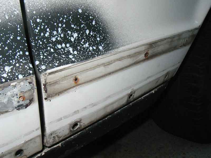

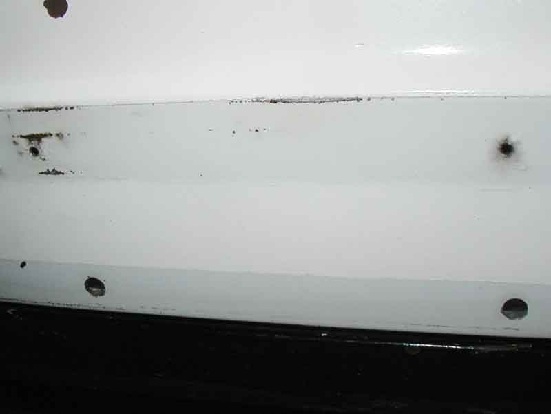

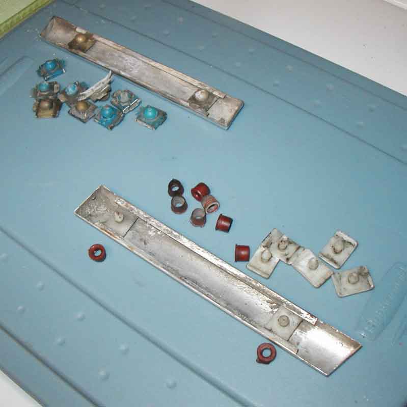

There are  two varieties of trim strip attachment hardware in use on my car. In the photos, the lower series of holes accept these fastener blocks, the upper holes are where the sheetmatal screws secured the upper trim strip.  Method A uses a one-piece knobbed device that engages a hole in the door. Method B uses a conical stub device that snaps into a push collar that is inserted into the door. I need some of each variety.
Of additional interest is the photo of the contrast between the original paint ( #717 Papyrus ) and the overcoat applied later on. As you can see, the grey cast to the 717 white made for a very dull look, sort of dirty white.

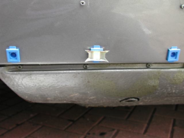

The blue and yellow trim clips in the top right of the second picture are the correct clips for the Pagoda, and available from any dealer.
The red inserts seem to be from a 107, not sure where the other ones are from.

An often discarded piece of the trim clips is a metal spiked spring tab that goes on one of the plastic tabs of each of the moldings. They were installed between the clip and the insert button. These are to keep the mouldings form sliding forward or back and interfering with the doors.
Or are these not available any more.

I didnt see the pic posted by NAJ I see they are still around.
