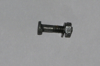

this is Bob again. I found the "culprit". The mechanism that was getting the acceleraor stuck is the one attached to the injection pump (see the picture)
Download Attachment: spring.jpg
51.03 KB
unfortunately, after disassembling the spring an the bolt that conects the mechanism to the pump, I haven't been able to reassemble it. Also, the injection pump now is functioning badly.
Basically, in order to fix something minor, I have a major problem. Please help: how do i reassemble the spring and the bolt that keeps it pressed against the pump?
see picture:
Download Attachment: bolt.jpg
30.91 KB

I hate to give you the bad news, but if you removed the armature from the IP you are probably in for a big job, if you can return it to it's original position I would be surprised.  These typically require someone very experienced with IP's, that is why every book I have cautions against removing this.  That said, if you have the car running at all you are lucky--if you start (or try to start) the car with this too far out of its intended position you can actually do some damage to the internal mechanism.  Don't ask me how I know...
One of the experts on the board might be able to help you to work backwards to get this at least close to correct, but I fear your IP is in for a trip to a specialist.

Bob, these cars aren't for everyone.  However, once you "skin you knees" a few times, you'll begin to understand what is complex, what isn't, and why.  If the only thing wrong with your car is the FI pump, it would be shame to sell it out of temporary frustration.
The FI pump is not that hard to remove and ship to an expert.  It may cost $100 to get it put back together and properly set-up.  Re-installation requires attention to the timing marks and care attaching the fuel lines, but that's about it.
This bolt is a lesson that German engineering is not always obvious from the surface.  Information is key before removing anything.  If you really don't enjoy learning the systems of the car, their interrelations, and being able to tweak them, then perhaps you should sell.  But it will be easier to do if it's running.
