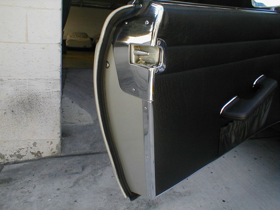

Here's that photo I mentioned from motoringinvestments.com:
Download Attachment: djam1.jpg
81.82 KB
(As you can see, the chromed plate just screws into the door.)

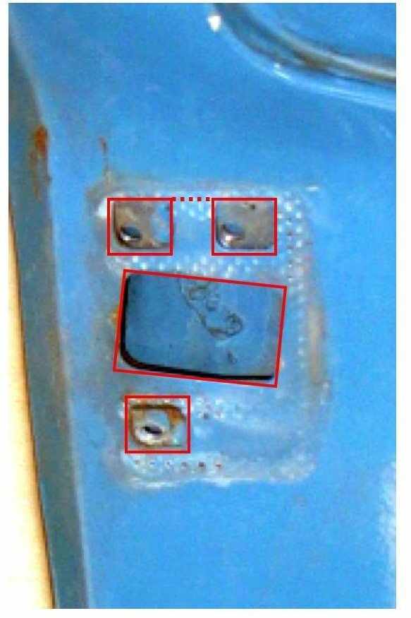

Hi, Bob,
For the door striker plate, captive nuts are in place.
Here's a picture from my 230 which has a 3 screw striker:
Download Attachment: DrJmb006.JPG
34.71 KB
I believe your 280SL should have a 4 screw striker plate.

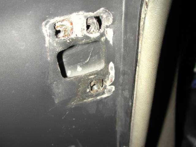

« Reply #19 on: August 13, 2006, 23:48:00 »
on my "late" 230SL there are 4 openings in the frame, 2 upper and 1 lower through which the bolts go into fixed nuts (see picture). These nuts are part of 2 movable plates. Although I have not tried this, I believe these 2 plates can be removed or added through the larger opening in the middle. You can also see the outline of the 3-hole catch imprinted in the paint.
When I removed the catch on my door frame I was initially scared when I saw no retaining nuts until I realized that the plates hade moved within the frame and needed to be pushed into place again.
Download Attachment: Catch.jpg
34.58 KB
