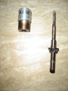

Hello Cortez,
Sounds like a worn "vertical timing gear" and or the "aluminum bronze bushing"  are allowing the oil pump to disengage. It is critical that you remove the tachometer cable at the engine and remove the aluminum and bronze bushing and the vertical timing gear to check them for wear.
Download Attachment: removal of verticle gear.JPG
60.1 KB
Search up the information on this site or ask for more information. This is very serious!!!  It seems that your problem is intermittent but it will not last. You may loose your engine if you  do not look into this. I would definately not drive it.
The oil gauge is mechanical and seldom fails.
« Last Edit: August 05, 2006, 22:26:30 by ja17 »

« Reply #6 on: August 10, 2006, 14:24:28 »
Here are my worn verticle gear, I have forgot who asked, but here you can see them, and they are very bad ( and very expensive )
Download Attachment: WORN GEAR.JPG
20.26 KB

Re: Oil pressure & RPM gauge
« Reply #7 on: August 10, 2006, 18:32:07 »
But much less expensive than a new engine.
« Reply #8 on: August 11, 2006, 13:47:51 »
That big thrust bushing can cost a few bucks, too.  I hope you don't have any significant engine wear from this.  While you're at it, have your mechanic make sure your oil filter housing has the thick top seal in it.  This seal is like a 3/4 inch section of garden hose and it should be stuck up in the filter housing.  Without it, you're not filtering oil.
