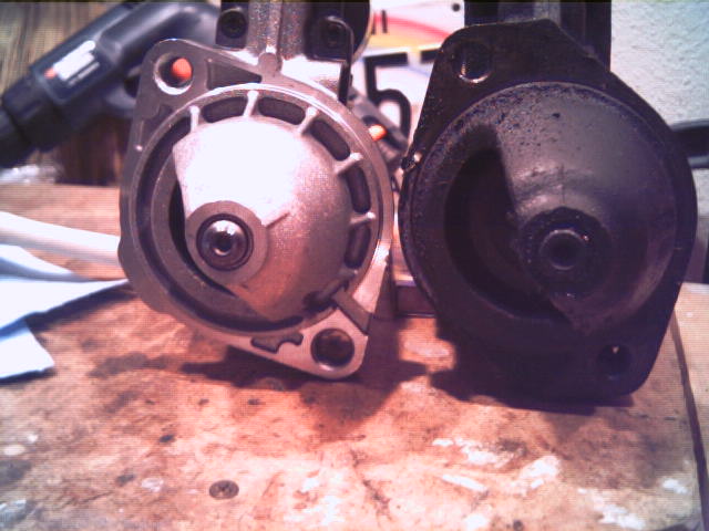

I received my replacement bosch SR 59X starter today.  thought I would post some photos for everyone.
The photo marked front shows the front of the statter where it installs.  The new starter is basically the same as the original starter, except for the lower bolt hole is drilled thru and is not threaded.   per other posts below I will need to purchase another longer bolt with washer and nut.

Also, the new starter is much smaller and lighter than the old starter.  there are no markings as to the hp output on the starter or the box.
hope this is informative
