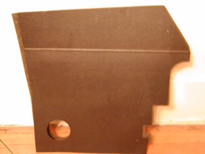

Does anyone know where my under dash panel fits? It is supposed to be the left hand side panel, but I can't see how it would fit. Does anyone recognize it from the picture?

Tom: the left hand side panel is supposed to have a round hole in it and a "slit" which as far as I know goes around the brake pedal. It is not very obvious how the panel goes in, just play with the orientation and it should become clear.

Your panel look somewhat different from mine. No "slit" to fit around the brake pedal. Still, I think the orientation is how it should go in. Were you succesfull in installing it yet?

I haven't really tried much yet after I held it in place. I just couldn't see how it would fit. Aside from the slit yours looks the same?

I've had my panel out for awhile waiting to put replace the foam insulation material backing... so it was easy to make a direct out of car comparison with the pic of your's you posted.
Bottom line is your panel looks unlike mine.  My best guess (based on below) is that your panel isn't for the under-dash area on the left side of steering column.  FYI, the fold line is at the fire-wall end of panel... the short folded section sit's roughly against the firewall padding, the rest of the panel under the dash itself... but your panel's missing a bunch of cut-outs required for clearances, so doesn't appear to apply to the 113 chassis under dash left side.
A suggestion:  Go to someone / car lot that has a 113, borrow their panel... lay it over yours, line up the circular holes and at least one edge simultaneously, then trace the other panel's outline onto yours... then use the appropriate sharp cutting tool(s) (or fasten a punch --- ha ha) to cut a correct fitting panel from the panel material you have now.  If that isn't possible, have someone send you a paper cuttout of their panel to use as a pattern... or find one at some MB classic part's dealer.
A pic's worth a thousand or so words, but it's a lot more trouble to get a pic of my panel, and time consuming for me to get it posted, so words will have to suffice.

What I can't fathom though is how the folded edge end of your panel can allow the brake and clutch to pass from their pivots above the panel to their foot pedals... since you have no slots or clearance features on your panel for same.
I'm judging the size of your panel's length from fold to end by the number of diam's of your hole... being about 5 to 6 hole diams from end to fold-line.  If your hole is 3" diam as mine is, then the length of your panel is about 15" to ~17"  in it's long dimension from driver's edge to firewall fold line.  This is at least 2 if not 3" longer than mine for that dimension, and mine fits flat (relatively) between the underdash metal edge nearest the driver (with a slight overlap) and the firewall padding.  This implies that a 113's underdash panel area are about the size indicated by my panel --- since my panel fits nicely and securely in that area.
If your hole's 3" and my estimates of your panel's length is right (front edge to fold-line), and there's no cutouts to let the brake and clutch pass, then perhaps your panel is't from this car... i.e. not a 113 chassis under-dash panel.
But... since I've only examined my panel carefully and no others from any other 113's, this is just my conjecture without any other foundation than I described above.

it seems that there were some different left under dash panels for the W113 (I guess we are speaking about a LHD Pagoda), because SLS in Germany sells two different versions, and only for automatic cars:
SLS Ref.: 268273 for all 230 SL and 250 SL up to VIN 2979
SLS Ref.: 268277 for 250 SL from VIN 2980 and all 280 SL
So, at least, it should be one or two more versions for manual cars (with the place for the clutch pedal).
Maybe you have a wrong version for your car.
Anyway, according to the SLS drawings of that parts, your "Left?" under dash panel seems very similar to the Right under dash panel (See attached drawings):

The pad pictured matches my old one for the right hand side.  The photo is essentially upside down. The edge at the top of the photo goes along the firewall, the left edge in the photo goes along the kick panel (to the right), the edge at the bottom along the dash itself, and the jagged edge fits around the heater box.  I don't know what the hole is for -- mine has one also.  The new pad I got from K & K has no hole, and fits fine.
