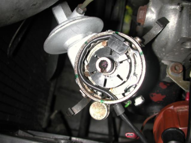

1)  My DYING issue.  This may have been solved.  The Crane ignition system which had been in for 5 years and working well for most of that time might have been the culprit.  What there was evidence of is the plastic shutter wheel which fits over the distributor shaft may have been making contact with the insulation jacket around the wires that go to the optical assembly.  Since this wheel doesn't fit very firmly--held on by spring clips--if contacting a fixed object it might very well simply spin around on the shaft.  If that was the case, it would have prevented spark.  Try as I might I could not seem to tuck these wires out of the way--they kept spring back too darn close to the plastic shutter wheel.  The cut marks indicate something hit the wire.
2)  COIL/BALLAST  Mechanic simply bypassed the ballast, providing full voltage to the coil.  With the RED coil and the 1.8 ohm resistor, I was only getting 5.2 V at the coil primary.  Mechanic wanted to see more.  With the ballast bypassed we have 12V+ of course, and a 23kV spark as seen on the scope.  I ran home on the highway yesterday about 40 miles, at 90 degree ambient temperature, and at about 70 MPH.  I checked the temps inside the engine bay via infrared thermometer: inner fender wall (ambient) temperature, 115.  Coil case, 126.  Valve cover, 165.  I don't think this is excessive heat for the coil, so maybe the no ballast will be OK.
3)  RUNNABILITY.  I had mentioned in earler posts that at steady state 45mph, non-accelerating, I was having minor misfiring and backfiring.  Pete Lesler (National MBCA guy and long-time 113 expert)indicated it might be too lean in the mid-range.  Mechanic independently came to the same conclusion, richened up the mid range a bit, and this problem went away.
4)  CRANE vs. PERTRONIX.  Well, after item #1 above, I removed the Crane, only to find that it violates the integrity of the 051 distributor: the shutter wheel contacts the points pivot pin, thus this has to be removed to install the Crane on the 051.  Once you remove the pivot pin you can't go back to points OR the Pertronix so my advice is DON'T DO IT!!!  It may not have to be done on all distributors, but certainly on the 051.  I luckily had the distributor rebuilt with the right pin replaced, went to Pertronix and so far so good.
Here's a picture of a Crane system installed in an '051' distributor.
Using the smaller of the two 6 slotted wheels means you can retain the post for the points and have enough room for the wiring.Hopefully it will save others from the problems you've had.
