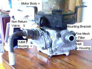

Hey Bob,
Before removing the pump, take the hose off and use an artists brush to probe around in the inlet connection.
Take it out and if it is covered in gunk then you know it will need cleaning.
Here is a pic of the fitting on the old style pump.
Maybe you could remove the whole fitting with the 4 screws. Then when the filter is clean use a new o-ring to seal it.

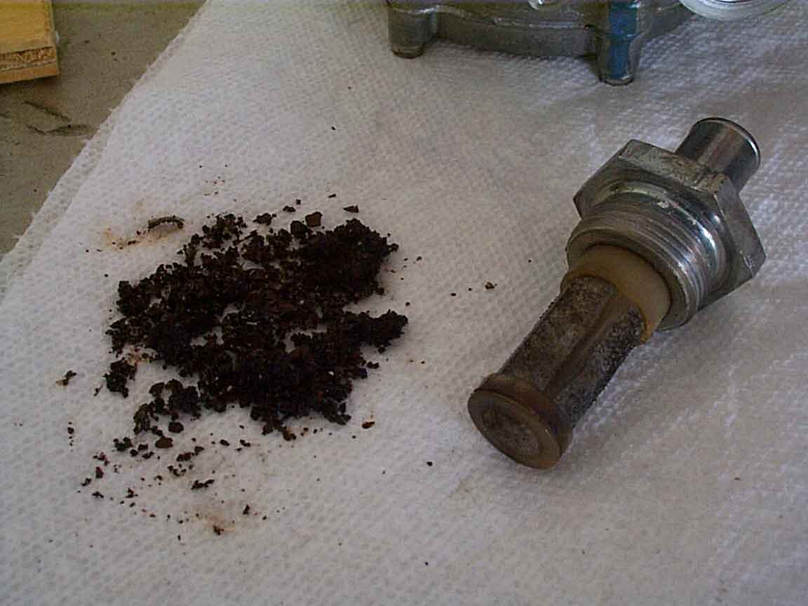

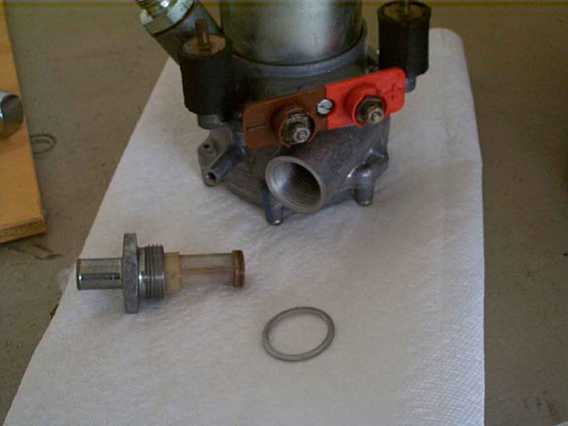

Finally got around to remove my fuel pump today.  Pump was easy to remove.  Clamped all hoses, etc. and removed pump shield, then pump.  With the pump in a vise, took a bit of force to remove the filter.  WOW!  I could not believe how much "crap" was in the small filter.  Not sure how my car even ran.  See attached pics of before and after.  It was similar to cleaning a coffee filter full of coffee granules.  Note: I purchased my car over 2 years ago and replaced my gas tank w/new at that time, and also had Hans rebuild my injection pump.  Also, at the Tech Session last summer in Ohio, Joe tested my fuel pressure and it was on the low side, but as I recall, still within spec. Overall, car has been running very well.
I am currently in watching the shuttle launch (count down) and have not put the pump back on, but very anxious to re-install and see if engine starts, runs smoother.
Even if I don’t notice any difference, this is still a very overdue maintenance item on my car...

« Reply #7 on: July 04, 2006, 12:35:32 »
Your picture give a pretty good idea of how this build up can block the fuel flow. It also gives a strong hint on what can cause the older pumps to go bad, especially the ones that do not have an inlet filter screen and I've come across many. My guess is that early pumps on all the FI models came this way and that DB may have received a lot of complaints so the inlet screens were added later in production by Bosch. This same crud gets between the sealing surfaces of the main bellows seal and wears the surfaces so they don't seal anymore. Also the build up can "lock up" the vane and when power is put to the pump it overheats and burns out the windings. Trying to "unfreeze" the vane often leads to breaking the small tang on the seal driving washer which leads to the shaft spinning in the bellows seal with attendant leakage though the main shaft o-ring. Point is, this crud is very bad for the fuel feed pumps--old or new. I'll leave it to Hans and others to describe what it can do further down stream if it gets past the fuel feed pump.

« Reply #9 on: July 04, 2006, 14:38:30 »
Hello Bob and all others - - I think I need to go on record here and suggest a quick REALITY CHECK !
Bob, you would not be seeing that kind of crud accumulation in the filter unless your tank is well along the way to being completely  rusted through.  When you see rust scale like that, think of  the old cliche goes " - -  there is more where that came from - - ". You are not fixing the problem and eventually  you will start smelling gas fumes because the top of the tank will finally rust through. I know this because it happened on mine. I urge you to drop the tank and have a look at the interior of it.
Regards, Larry in CA

« Reply #10 on: July 04, 2006, 17:37:37 »
Hi Larry,
I agree!  However, in my case, I replaced my tank, with a brand new MB tank shortly after I purchased the car.  I should have performed the fuel pump filter cleaning at that time, but I didnt know there was a filter in the pump at that time and have put this maintanence off for too long!  When I replaced the tank, I also had my fuel injection pump rebuilt.
The reason that I replaced my tank is that the previous owner did the tank re-liner route, vs replacing.  When I went to fill up the tank for the 1st time, I noticed a "skin" like material peeling at the opening of the tank, by the fill area.  I knew that if I didnt replace the tank w/new, that I would be fighting the rust, crud issue and never being pleased with the perfomrance of that car.
So, I agree, if you see this much "crud" in the fuel filter screen, you have bigger issues...  basically, need a new tank at a cost of 800-900 bucks.

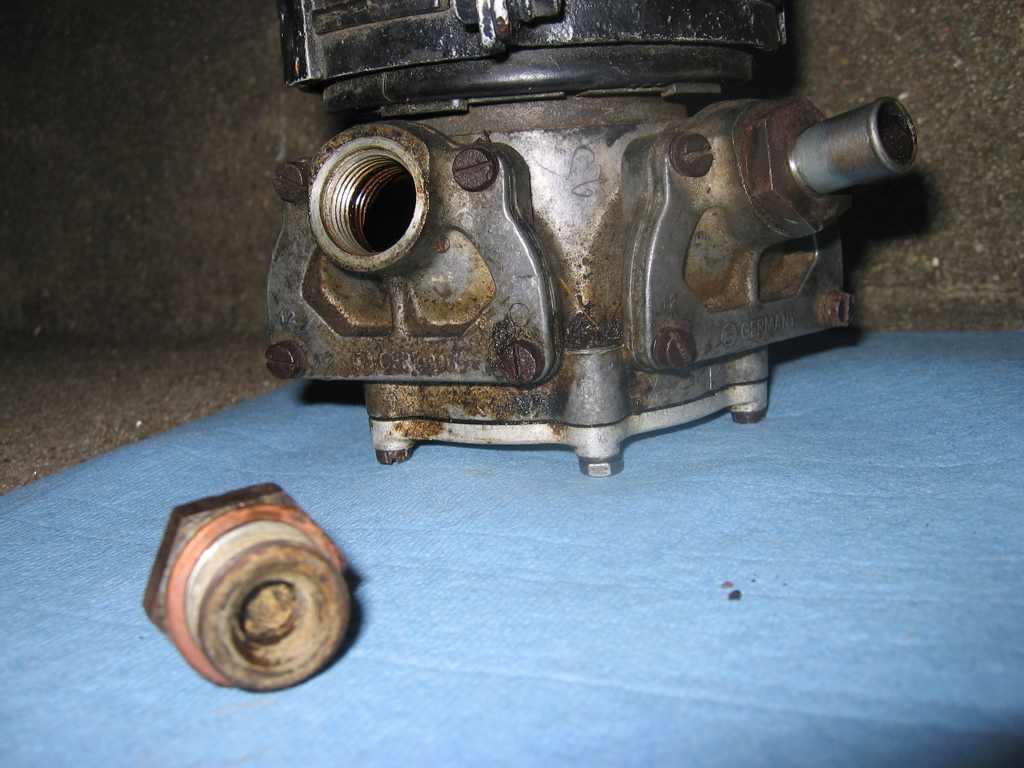

Sorry to resurrect this discussion, but I'd like to join the fray!
I've been cleaning out my fuel lines and filters this weekend. Specifically, the tank screen (was fairly clean), replacing fuel filter (gunky!), blowing air through the feed and return lines (forward-to-rear), and passing some old guitar (bass-E) strings through the internal fuel-tank lines to/from the "flower-pot" (with kind permission of the Dr Benz). My last task was to clean out the fuel pump screen, and I discovered I had the old-style fuel pump. Is it true that NO old-style pumps had screens? Can a screen fitting from a new-style filter be used on an old-style filter inlet? (do the threads match?)
I removed both inlet and outlet fittings to look inside the lower housing. Upon closer inspection, the outlet fitting (connected to engine side of pump) contained some kind of loose metal plate or mesh (I couldn't tell). Is this normal? I tried to take a picture, but it's not quite clear. Any ideas?
http://www.sl113.org/forums/uploaded/Waqas/200692542223_old-style-fuel-pump.jpg

Re: Fuel Pump Maintenance
« Reply #14 on: September 25, 2006, 04:21:48 »
WAQAS,
Many of the earliest large style pumps did not contain the inlet screen. I'm not sure when Bosch started adding these to these pumps, but I have noted that most of the ones with a screw type inlet fitting do not have it. The screen is exactly the same for both the large and small type pump, so if you're lucky enough to find a screen in good shape on a salvage small style pump, it is a simple press on fit to the inlet side fitting. I took a look at your picture and what you have off is the outlet side fitting. I think what you are calling a metal plate is actually the check valve that prevents fuel from flowing back into the pump.

« Reply #15 on: September 25, 2006, 04:32:04 »
Of course! A check valve makes perfect sense... thanks!
The picture was indeed of the outlet fitting, and I was trying to show the newly-identified check valve. The inlet fitting did not have a screen attached to it, but I was wondering if there was some other screen within the pump...... I gather not, from your post....
So on to my next question: assuming I can find a salvage new-style pump's filter screen/fitting (which is unlikely at the moment), once attached to the old-style pump inlet fitting, will the screen interfere with anything (impeller, etc) inside the old-style pump? I haven't opened my pump... no reason to...
Thanks for sharing all this valuable info!
