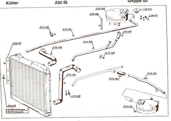

Does anyone have a drawing or graphic of how the pieces go together (such as routing of the water lines and how the Y junction fits).  I know I have all of the parts and hoses, but would like to make sure that I fit them all in properly.  Any suggestions on how to clean out the exchanger, which has been sitting collecting debris for the last couple years, would be helpful.  Hopefully the oil flow is into the exchanger and then into the oil filter....  I would rather not remove it from the car to clean it out if at all possible.
Thanks and regards -- Roger

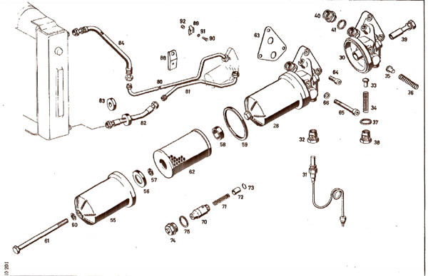

Hope this pic helps.
Download Attachment: cooler.jpg
37.95 KB

Thanks for the jpeg, but I think it is a different oil cooler approach.  My heat exchanger is on the driver side engine mount, with two pipe connections to the oil cooler and two water lines going to I don't know where - one is to a Y in one of the radiator hoses, the other ???  That's why I need a diagram....
Thanks anyways -- Roger

Sorry about the 280SL pic.  Here is all that I have on the 230Sl cooling system.  Hope it helps.
Download Attachment: 230sl cooling.jpg
41.45 KB

Thanks for the effort on the jpeg.  That covers mostly the coolant reservoir.  It appears that one of the coolant sources is from a freeze plug outlet in proximity to the heat exchanger.  What I need to know is the other coolant source.  There is a tube that is routed around the sump to the passenger side of the car.  A 'Y' taps into a coolant source, but it is not as yet obvious how that works.  Anyone with a heat exchanger please let me know how the Y is integrated into your coolant system.
Any suggestions on flushing the heat exchanger would be appreciated......

Roger, More important than the pros and cons of the oil cooler-  PART 58 - the rubber seal on the top of the filter. If it is missing , no filtration- worse than hot oil.
37.95 KB

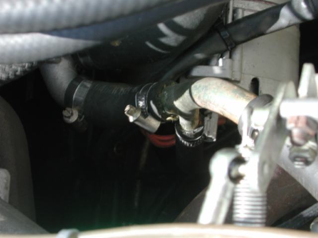

Hi, Roger
Download Attachment: DSCN0432.JPG
28.43 KB
The middle leg of the 'Y' connects to the tube going down and round the engine to the bottom (& front)of the heat exchanger.

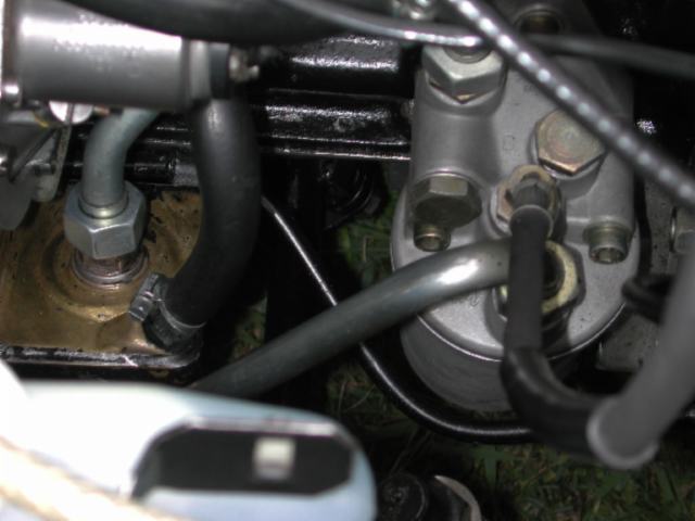

The rear (upper) outlet on the exchanger connects to the block here. If the pipe adaptor has been removed from the engine, it will have a hex plug (17mm allen key).
Download Attachment: BurghHse055.JPG
35.03 KB
Hope this helps
