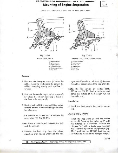

There were two pieces that Gernold sent me that I was unsure of and have been corresponding with him.  They are "bounce up" stops.  The problem is that I don't have the mounting hardward for these and cannot envision exactly how they mount and secure.  Does anyone have a picture or diagram, including hardware, of these pieces.  Gernold correctly said that it would be likely that mine were missing, as are most others.  Joe Alexander, do you have a "tour" of this stackup and installation process?

Here is a diagram out in the BBB. The plate is used below the mount with a bolt holding it and a rubber bushing.  I have not done a tour on this subject yet but I do have a post here somewhere on changing these mounts. Good Luck.
Download Attachment: mounts.jpg
52.56 KB
The lower bolt is installed with the rubber bushing and the bump plate, then the entire assembly is installed in the car.
Download Attachment: mount2.JPG
51.06 KB
Joe

Thanks guys, that helped a lot.  There is much to learn on these cars, especially when following a previous owner who was less than exacting in his choices.
I appreciate the time to post and send the info.
Ed

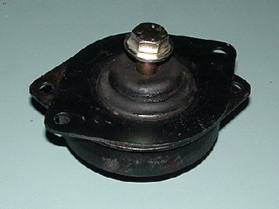

Attached is an image that Gernold sent me, with the correct bolt for the bump up stop.  Hope this helps someone else in the future who is missing parts.
Ed
