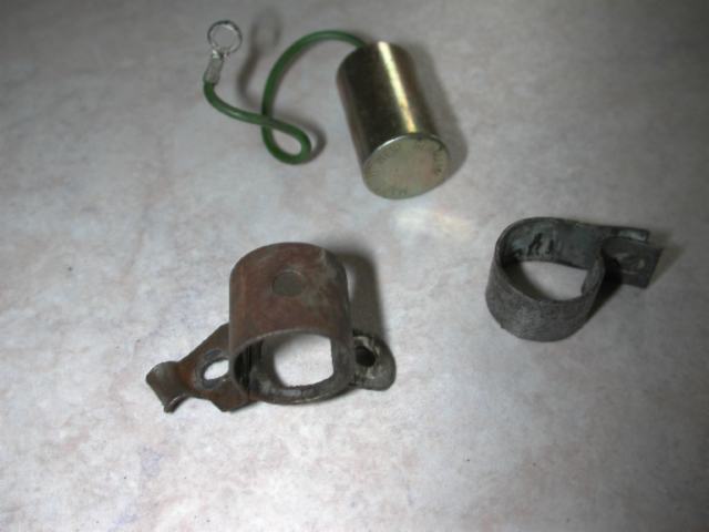

My car never had when I owned it, the condenser.  I located the condensers locally and they have the NEW Bosch part number 02006 which crosses to the one Naj supplied.  Problem is there is no mounting bracket on it.
Miller's tells me the original condenser had a welded on bracket, typical of Bosch condensers I remember from my VW and BMW days.  Then they eliminated it and there was a separate bracket from MB.  Now the condenser bracket is NLA, according to Miller's.  This should not be so difficult!
Anyone got a story here for me on why there are condensers with no way to mount them?  I have 2 new Bosch condensers and no way to mount them....

Thanks Naj. Mike, I just looked at my bracket, seems it could be fabricated easy enough (I know you are a stickler for the real McCoy but its just a thought). Used may be your next option?
PS my bracket looks to be screwed on

Yes Jim, I'm a stickler for the real thing...but a used condenser?  It looks to me like these are electrolytic type which have a "shelf life" as well as a practical life; it isn't the kind of thing one buys used.  I think I need to find a used bracket though or somehow find one to copy or something.  Doesn't look at this point like I'm going to get much driving in this year, just getting all this stuff (and I'm not done yet clearly) has taken me about 5 weeks.
As a side note, when the restorer put my car back together 5 years ago I don't know what condenser he used, but the points fried in 30 miles (on a rainy night in November, of course) so you can see my reluctance to find a used condenser; that's what is supposed to protect the points.
Any mounting bracket ideas are welcome.

Should be able to get a second hand bracket from almost any old Bosch distributor or could fabricate one similar to the one on the right in the picture - or a copper 'P' clip from a diy store??
