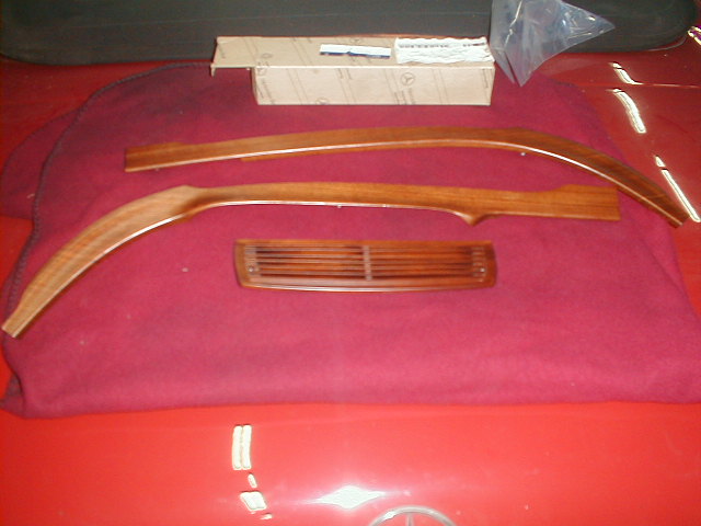

A friend of mine just ordered and recieved new dash wood for his W113 Mercedes from the local Mercedes Dealer. I thought some of you might want to see the color and finish of the factory new wood.
Download Attachment: wooda.JPG
57.46 KB
Download Attachment: wood.JPG
56.86 KB
I believe the actual type of finish has changed from the original and the color may be slightly different. It is very close and looks very nice. It is a dark color, maybe not quite as dark as the older wood. It has a low sheen finish. It is not a glassy smooth finish like the newer Mercedes cars. Some grain texture from the wood has been allowed to show. I believe this to be correct also.
The price was quite reasonable compared to what wood restorers charge for restoring original wood sets.
Unfortunately a recent price increases by DC raised the price of the wood sets significantly.
Be aware, this wood is not meant to be installed without removing the front windshield!

Its nice Joe. Who sold it and how much?
Is windshield removal always required for replacing the wood?

What was the cost and part number? Does the speaker grill have the raised slates of wood like the orginal?

I got a 4 piece set from SLS two years ago. The price today is Euro 493.- (includes the wood box between the seats)
It is possible to install without removing the windshield. You need to place a flexible steel or plastic plate underneeth the protruding bolt when sliding the left wood bow over the speedo/tack hump.

    My understanding was that matt finish is original and that the gloss finish is more of a newer thing.  I can tell you the gloss is a lot harder to get right.

The color and sheen looks pretty close to the original finish.  It does seem a touch more transparent than the original finish. The original was basically color tinted lacquer, so the grain was somewhat hidden.  The finish in the picture appears to be stained and finished separately.  Very nice.
I have removed and reinstalled the wood with the windshield in place.  I use a thick leather pad over the instrument "hump".

I had a set of repro dash wood covered in macassar ebony veneer and it looked fantastic. Since the wood is new it doesn't need any repairs so the cost is reasonable. I got the wood unfinished since it was being covered.

I think your wrong about having to remove the windshield. The wood has to be out in order to install the windshield. No exceptions.
However the new wood has to trimed and fitted to the car. This takes a minimum of 3 hours if you are lucky. The wood is always too long on the outer edges which affects where the 2 pieces meet in the center of the dash.
I'm going through the process as we speak.

Yes you guys are right. The winshield does not need to be removed. Also as stated the wood should also be off the car if the windshield is being replaced. I'm sure that it is not always done this way but it is the best way to insure that the rubber windshield seal seats correctly.
The wood on the driver's side is a very, very tight. You must protect the guage cluster from the studs (as mentioned). The wood also needed some minor fitting adjustments to lay down nice and snug. I am sure these pieces are hand fit to each car at the factory.
If you replace the windshield and use a new seal be prepared for a long day. These new seals are quite a challenge to get back on the windshield. The factory new windshield seal from Mercedes was around $80.00 US. I thought that to be reasonable.
Hello Chad,
The owner of the car went to Mercedes and ordered the new wood. He got a slight discount but paid less than $500.00 for both right and left. He also got the wood speaker cover for around $240.00. Yes the speaker cover is as original with all the parts and pieces glued together. Since the wood was recieved Mercedes raised their prices, so they will cost more now.
