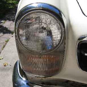

Hello Pagoda GURUS  - - -
I've got some weirdness going on with my 230SL headlight assemblies.
How many US versions of the headlight door assembly are there?
The 230's  have  an amber filter behind the clear lens, but only on the bottom third of the rectangular section, correct?
The 280's have an amber filter behind the entire rectangular section, right?
What the heck do I have here?  Is there a third configuration?  and if so how is it supposed to look compared to  the other two?
HELP ! - - - Larry in CA
Download Attachment: 230SL-headlight-door.jpg
2.64 KB
Download Attachment: 280SL-headlight-door.jpg
5.23 KB
Download Attachment: my-headlight-door.jpg
10.63 KB

I know the 280sl has two versions.  I have the older version and the bottom is amber but the middle light has a clear lense and uses an amber bulb.   I think the later version may be all amber (not sure)

Hello Larry,
No you are not crazy.
There are three versions of the USA headlight door that I know of.
early: up to chassis 5607
middle: 5608-11040
late: 11040-end.
Late ones had the pigtail socket to plug in the side markers when they changed from reflectors.
They are oftened identified by their stamped in product code (not the MB part number) which usually end is -AN or -AJ or something like that.  I wrote a long post on it some time ago..search the archives.

To complete Michael's write-up.....the serial numbers referenced pertain to 280SL models.  All USA 230SL and 250SL models were furnished with the first version only.
