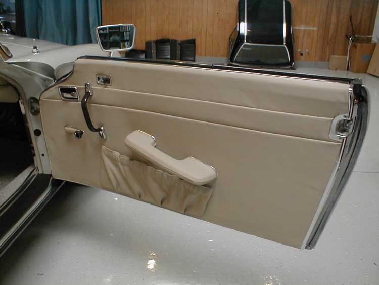

Achim is right, of course. A 280 SL should definitely have a color-coordinated door handle. (Remember that your gorgeous SL once had a black interior.) You can dye it to match flawlessly, of course.

Here's the factory right-side door pull from a 1970 US-spec 280 SL. As you can see, it matches the door panel:
Download Attachment: pull.jpg
8.34 KB
