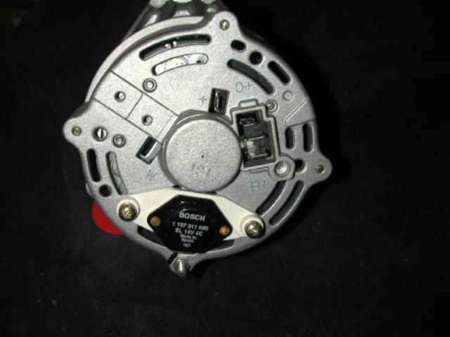

With a properly functioning alternator, i get 14.4 volts at battery with engine running.
55a alternetor Part #s:
MB: 008 154 3202
Bosch: 0 120 489 506
Bosch Exchange: 0 986 031 020(This is what I've used on my 280)
Comes without pulley. Has internal regulator.
Needed new plug and ran extra wire to D+ from loom.
Download Attachment: Alt55aIR4.JPG
31.61 KB
