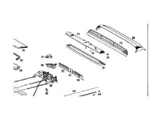

James is correct.  You can see the washer tube elbow when the chrome cover is removed.  The tube itself is secured by small metal tabs on the underside of the cowl cover.  A mirror may help you see it.  The louver itself has a pin hinge on each side.  I think there are two small bolts near the ends of the louver that secure it to the pin.  The louver itself is metal.  There is a rubber gasket which runs around the louver to enable a tight seal when closed.  It appears as if the rubber gasket has been painted.  You can maybe take a x-acto blade again and try to break the seal between the paint and the rubber gasket.  If you want to operate the vent this will have to be done at some point.  I purchased a new seal some years ago.  Check to make sure you can by a new one and then just cut the rubber out until you get to the painted surface.  Here is a pic of what it looks like.
Download Attachment: louver.gif
18.13 KB

« Reply #7 on: March 30, 2006, 02:50:21 »
Z,
Removing the scoop is fairly easy.
There are two screws on its rear, just below windscreen. Yes, the paint will come off but they should be chrome anyway.
There are 3 or 4 more screws which need to be loosened but not totally removed. You should see these thru the scoop behind the air flap on the fire-wall.
Then the scoop should just lift up.
You can also remove the fresh air flap by unbolting one of the end hinge pins, and clean out the air box and the air filter which will be visible one the flap is off. Routing the washer tube will be much easier now.
The washer jet is held to the scoop with a spring clip. This can be removed for cleaning out the jet.
