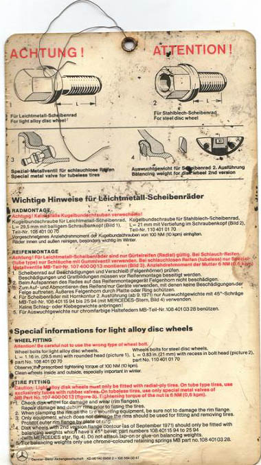

After the alloy wheels were introduced, all the cars came with a warning tag in the trunk describing the long and short lug bolt situation.
Actually the longer bolts and steel wheels will not cause a problem in front, however as you noticed, the long lug bolts when fitted to the steel wheels in the rear will protrude through the flange and collide with the emergency brake shoes as the wheel turns. Not an ideal situation!
Occassionally these tags will turn up still intact. Here is a view of one;
Download Attachment: Trunk tag.JPG
79.24 KB
