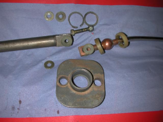

As the good Doc. says:
Check these plastic bushings under the gear lever; the snap ring gets well beaten up too and sometimes comes off when the bushes are worn out.
Download Attachment: GrShft03.JPG
33.43 KB

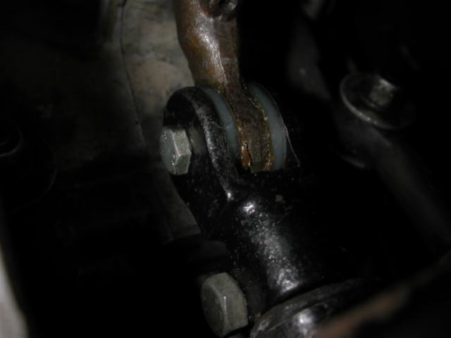

and at gearbox (Xessible from front cover on tunnel)
Download Attachment: GrShft14.JPG
18.59 KB+

  • Posts: 7513
Re: No Reverse Manual Transmission
« Reply #4 on: March 23, 2006, 18:03:31 »
Yes we are all in agreement on this fix. Order all the shift  bushings and you will be set for another twenty years!

« Reply #5 on: March 24, 2006, 10:28:48 »
Thanks for the responses everyone.  I pulled up some more carpet on the tunnel to reveal the second access panel.  Sure enough the bushings were shot on the linkage close to the transmission.  Easy fix and now it shifts great.
