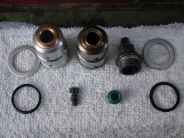

Job Done.
BUT the end play is just as bad as the original Thrust Bush.
Let me say ‘this is not a job for a ‘total amateur’ like me.
While everything wasn’t going smoothly I cursed myself for being a cheap skate and not having it done professionally at $128.00/hour.
However now that I have the bush installed and I know all the correct procedures I wouldn’t hesitate to do the job again.
In fact I intend to fit shims to the old Thrust bush between the bronze bush and the aluminium holder then re-install it and see how it goes.
Many times I used my multigrips on the Thrust Bush to break it out of being jammed in the head. This may not be the best approach but I tried using ice and tapping it into a different alignment. Without success.
A couple of burs formed on the Aluminium housing so I filed them smooth and cleaned it up. Then I tried again and again and again.
Eventually the bush went in and settled right down. I aligned the bolt hole with the bolt already mounted in the side of the head.
I tightened the bolt and checked it was through the hole.
After installing the new o-ring seal I finished by adding the tacho cable.

<<In fact I intend to fit shims to the old Thrust bush between the bronze bush and the aluminium holder then re-install it and see how it goes.
 Measure the end play before you remove the tach drive piece and then you will know the exact requirement for the internal bushing spec...
 That is the best way to shim for total assembly wear.
The other reason for proper end pay [ aside from oil pump drive failure fear] is that the drive gear is constantly being worn from the rotaional force wearing across the gear cut facings everytime the gear moves up/down.. this is the last place you want wearing and a part you  do not want to be buying b/c both pieces have to be changed as a set and they are BIG $$$$..[ although the new replacement kit has been modified w/larger bearimg surface for better wear longevity].
  A .25 cent,  accurately measured, internally sandwiched shim ,in the correct place, fixes all..........

Arthur, I intend adding shims on the inside of the new bush and not the old bush that way the amount I measure will be real and I will not need to compensate for the clean up of the surface of the old bronze bush.
Joe, The car started up with no hesitation at all. I decided not to add oil.
James, You are lucky the bush went back easily.
The thread of the tacho cable connector may be a bit out of shape.
I cleaned the threads on my connector because of that. Then I screwed and unscrewed the collar onto it before re-mounting on the top of the Thrust bush.
I have a friend who has a lathe. I thought of using it to push the bronze bush out of the aluminium housing and then inserting the shims and using the reverse process to push the bush back.

<<Arthur, I intend adding shims on the inside of the new bush and not the old bush that way the amount I measure will be real and I will not need to compensate for the clean up of the surface of the old bronze bush.
 Yes, that is what to do...you might as well [ seeing your friend has a lathe] , have him face-off the old one and shim it to the total of the other while you are at it...then you have a spare already set/spec for that particular engine to replace the wear of the new one down the road. [ long term thinking..:)]
That may take some miles , but the original drive set are a high wear item, so might as well.....no cost involved and good insurance...........sure beats the high $$$$ cost of converting over to the new gear set.

As a follow up
After installing a new Thrust Bush I re-checked the end play of the gear shaft. and measured it at about 0.025"
This is not as bad as the original amount of play.
The aluminium injector washer I bought to use as a shim is about 0.048" thick... much too thick.
I decided that the amount of endplay of the shaft at 0.025" is acceptable to me.
So I now intend driving the car for a while before re-assessing the situation.

Would that washer have worked with the old Thrust Bushing, or was the wear on that part even greater than the thickness of that washer?
Hey Rodd,
I think the washer would work on the old Thrust Bush but I was reluctant to use it because it is aluminium and might be too soft.
I don't relish doing the job on a 2 yearly schedule.
In time if I need to shim the thrust bush I will use the internal bush method.
Those shim washers are extremely hard to find in my city.
Joe A posted this site http://www.mcmaster.com/ as a possible source.
I spoke to them and they will send to Australia if needed.
Re: Tacho Thrust Bush Replacement Questions
« Reply #20 on: March 16, 2006, 19:10:50 »
Fairly easy to cut an aluminum shim down to spec by hand with a flat piece of glass with fine emory paper glued to it..
 A mic. comes in handy for trueness......
