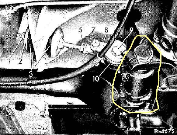

What is this part called?  It is part of the rear axle.  There are, what looks like, 2 rubber bushings, one on each end.  My bushings have fallen apart and only a small bit remains.
What's this part called and has anyone ever replaced these bushings?

That is called the hanger mount.  To change it the right side axle must be removed in order to get the hanger mount out.  An alternative suggested by Arthur Dalton is to remove the input flange on the differential and pull off the seal holder housing at the front of the differential.  I did the job last summer, but I pulled my entire rear axle assembly.  I had some discussions with Arthur that can be seen at http://index.php?topic=3879  You might also search on hanger mount.  I found the handling of the car vague and uncertain with a bad mount.

If all that I need to replace is the rubber bushing (part number 221-111 on the attached pic)can I just loosen the clinch bolts and remove the front bolt and lock washer and slide the bushing out and replace it?  Obviously, need to have the axles supported and at 90 degrees to the hanger?
What am I missing?
I ordered the new single piece bushing from Ray Paul today.  Nice guy!
Thanks!

<<What am I missing?>>
 You can not get the part past the differential front cover.
Vince Canepa
Re: What's this part called?
« Reply #8 on: March 02, 2006, 06:19:12 »
Bob - As Arthur points out, the forward end of the bushing fits into the "eye" on the differential front cover.  That is what the pinch bolt is clamping.  You can't slide the bushing aft more that a few millimeters even if you remove the shim between the aft end of the bushing and the right axle half.
Also, after installing the bushing, but before clamping everything down, the longitudinal position of the hanger bracket/mount must be set.  I'm not quite sure how you do that in the car - perhaps Arthur can help or posted on this earlier.  The measurement is from the face of the input flange back to the forward edge of the hanger bracket - where it fits into the top mount.  Maybe you can drop the center of the axle assembly down far enough to get the measurement.  I think the dimension is 168 mm.
And for more fun, the hanger bracket must be perpendicular to the axle tube.  The reason is to have the rubber in the bushing "without tension", as the Germans would say, with the car at rest on the ground.
This may all sound like overkill, but I cannot emphasize enough how important this mount assembly is to the feel of the car on the road.

I had to do one on a 6.3 a few years ago. For those who don't know, 6.3's have air suspension and there's a lot more work to R&R this axel. I did this job without removing the axel and it works fine.

Thanks for the post.  I was thinking that this job (replacing the support tube rubber mount) would not be possible w/o dropping the entire rear end (ensuring proper alignment, etc...)...  Your post has given me more encouragement to proceed.
As long as I ensure that both axles are perpendicular to the axle carrier tube/bracket, it should work, right?  Will I need to disconnect the trunk mount?  I am hopeing to leave that one alone since I already replaced it a year ago..
Any other suggestions or comments to help make this replacement go smooth?

I have this part available for 57 bucks and usually keep one around. It should be noted that Ray ( who I know and like ) actually works for Bud's Benz although he still works out of his home office. It's simply dropped shipped from GA.
I thought about this repair today while sliding through the CT machine and maybe the air suspension allows for the axel tubes to move upwards more than a standard rear axel. I remember having to tweak it into place, and it just went in.
I use an ordinary level and a framing square to set the axel up. I'm sure it's within a degree or two of being 90 degrees. You might have to drop the whole axel in the end. I've replaced quite a few of these mounts but the axel was already out of the car.
 Don't take the axel apart, they're really hard to make right again. The pinion nut can be removed and then put back on without problems ( usually ) as long as nothing else was disturbed. I've done it many times and it always seems to work out.

Bob - Dan seems to be confirming what I thought.  It isn't all that easy to do one of these in the car.  It took me less than an hour to drop the whole assembly out.  Then all you have to do is drift the pivot pin that runs through the mount aft far enough to remove the hanger mount.  Change the bushing, slip the hanger bracket/mount assembly back in, set the fore/aft dimension and the 90 degree angle, tighten all the pinch bolts and put the assembly back in.  The toughest part is compressing the compensating spring.  I made a compressor out of some 1/4" x 1 1/2" flat bar and some threaded rod.  I still haven't figured out how you set the fore/aft dimension in the car, although I am certain I have read how to do it somewhere.  Sometimes trying to avoid what looks like a big task actually makes for a worse task.
