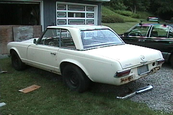

Eugene - any chance of you posting a photo of you and the car?

You guys want photos? Here they are! Just hooked up my digi-piece. Now now, no nay-saying. This project will get completed! (It helps when your dad does his own body work, and paint jobs).
Download Attachment: backleft.JPG
55.92 KB
Download Attachment: frontright.JPG
52.49 KB

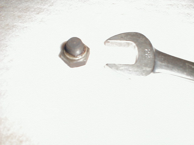

Man, today was a good day. Replaced the exhaust manifold with a hole in it, hooked up all the linkages just like they should be, and then was able to completely turn over the engine! We turned it over about 30 times. Good day, good day.
-One thing though. Out of boredom we decided to put a little water in the radiator. When we put water in the container, after about 3 seconds, the water quickly came pouring out a hole onto the ground. The hole is located halfway down the side of the engine on the passanger side. It appears to be threaded. Any ideas to what this might be?

Hello Eugene,
That threaded hole is probably where then threaded  block drain plug goes.

« Reply #22 on: August 12, 2003, 00:36:09 »
Augh! I can't find the stupid plug! I have two plugs that seem like they should fit, but they're just soooo slightly too big. Where can I get one of these plugs? Or is it just a certain size screw with a washer?

« Reply #23 on: August 12, 2003, 21:19:40 »
Hello Eugene,
The plug is a finer thread than the usual metric (M 14X1, 5X12 DIN 961) the MB part no. is 000961 014022. The wrench size is 22mm. This should be easily available and inexpensive from the dealer or donor sedan.
An aluminum seal ring is also needed with the plug MB #636 997 02 44.

Sphe
Re: Restoration has begun!
« Reply #24 on: August 14, 2003, 13:46:45 »
Thanks for the pic! It was one of the plugs we had already tried, but didn't want to go in, I went back to it, and it went it after a lil while. Back plate is almost on! Hopefully will start the car within a week.
