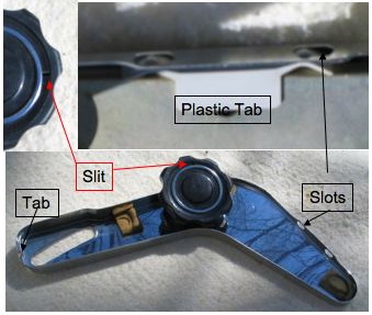

I tried your method but the part interior to the chrom ring broke out leaving the chrome ring and the outer rim stuck in the wheel. Perhaps the cover was already damaged since it was badly scratched on the outside; so, no harm done since I wanted to replace it anyway.
Curiously, however, the wheel on the other seat has a small slit and I could easily remove the cover with a large paper clip.
Enochbell,
my chrome trim has 1 tab and 2 slots that fit over a plastic tab on the L-bracket. It was easy to lift the chrome piece over the palstic tab with a screwdriver as you suggested. Below is a picture of the tab and the wheel slit in case someone else needs to do this.
Thank you both for your help!

Alfred,
Glad it is working, interesting that your '66 has a different (and improved) chrome attachment than my '64.  Now THERE'S a model change that not even the experts would have known about.
