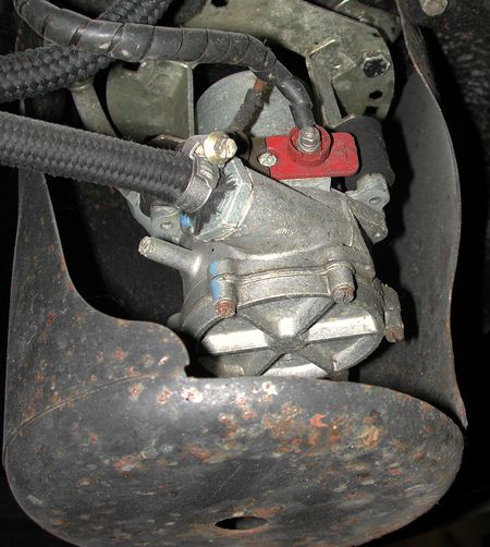

230SL:  The replacement fuel pump (in the rear) looks different from the original with outlets in different places, comes with a non-original adapter bracket, and doesn't fit under the protective can.
(Any suggestions about fitting the can will be welcome).

I like all the battle scars on your fuel pump can!  It looks like it's been doing it's job.
