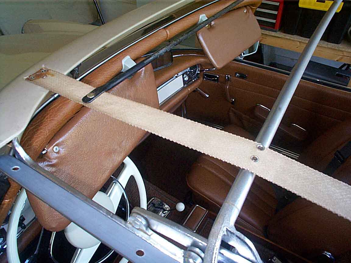

Hi Mark,
I think with the attached photo one can see the rivets that you are referring to.  This is a photo of my frame after I removed the old canvas and did some clean up.  I decided to simply clean my straps, instead of replacing them, prior to getting my new canvas installed.  I was told by the installer that he would not be able to make this look original again once he removed the rivets...
Hope the pic helps!
