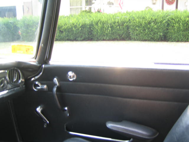

I've seen several 230 SL that have a pull handle on the passenger side door trim, similar in shape to the grab handles on the hardtop interior.  Is this something that is common and original to the 230 SL?  There is no such interior pull handle on the driver side, of course.
Just wondering if this is an example of something that was added and might need removed. You will notice the vintage Virgin Islands registration sticker and the shabby wrinkled dash covering which has been since removed in this pic.
Download Attachment: IMG_0692.JPG

Chad, if I am reading your post correctly, you are asking if certain 230SLs have grab handles like the hard-top ones. Mine does -- and on both passenger AND driver doors. Similar to your picture.

Your pull handle is normal stock standard item.

My February 1965 230SL has the handle just on the passenger door.  It is original

Same for my October 1966 production car. No handle on the driver's side.

I have an early '63 230Sl, body no.312, It has grab handles on both doors.

I have an early 250SL (before the 2980 VIN change) and it has no handle for the driver door (LHD).

The door pull is standard on the "off" side only.  I learned this the hard way.  If you put the handle on the driver side it will be in the way of your knee movement with the clutch (LHD) or foot rest (RHD).  Bud's Benz in Atlanta pointed this obvious ergonomic fact out to me only after I had installed the pulls on both doors. I now have screw holes in the leather on my driver's door to remind me of my error.

Interesting topic. My questions are: What was originally installed on the DS (left) & what was removed later for whatever reason? And were euro cars different from US delivered cars? Or were DS handles installed for auto trannys only? The reason I ask is that the DS handle on mine has threaded fittings beneath the door panel for installation that are almost certainly original. Why would they be there if not to hold a pull handle? Has anyone who does not have the DS handle looked for these fittings? Without the handle, there's not much else there to pull with unless the window's down. I don't have a problem with the handle in operating my clutch, but if I forget to move my knee from beside the steering wheel when I close the door, ouch!   -JP- '66 230SL Euro 5 Spd

I think we're waiting for someone with knowledge of the custom for this to weigh in, if there was a specific policy.  My suspision is that both door panels had the ability to accept the grab pulls, but that it was only customary to place one on the passenger side, at least in the US. A number of sporting (and less expensive) British and Italian cars of the era had no pull handles, so it seems reasonable that there be none, in deference to the spartan sporting nature. These cars were somewhat notable for their inclusion of comfort trim, however, so who knows. But the driver's door without the grab handle is certainly a cleaner appearance to me.

<<on mine has threaded fittings beneath the door panel for installation that are almost certainly original. Why would they be there if not to hold a pull handle? >>
 The reason is b/c the factory only made one door for each side , regardless of LHD/RHD.  When the car came down the line , the fittings were there for either option. [ look at parts book and you will see only one door listed per side.]
 Also look at the handle part# .. it states one part # and a footnote  *- Right side for LHD/left side for RHD.

My 1963 230SL had the grab handles on both doors and I don't think they are good to have.
I sat in the '63 and closed the door, the space between the steering wheel and the handle was very tight and would block the passage of the hand to the turn signal stalk and light control switch beyond.
So it would make sense that they always were on the door opposite the steering wheel.
