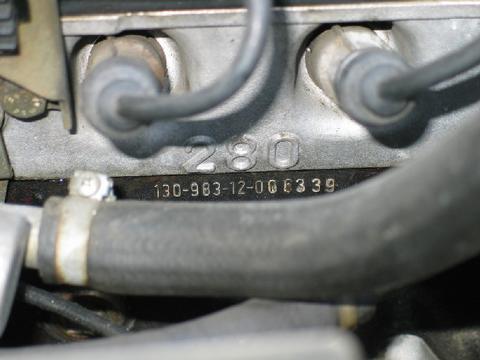

As for the engine serial number, what you noted down is not the engine serial number, but rather the cylinder head casting number, for a 130 (280) engine. On the cylinder head there will also be the casting "280 SL" as you note.
The engine serial number should be located below no. 6 spark plug, on the (usually black) cast iron engine block itself, rather than on the (aluminum) cylinder head. Now since this is a factory replacement block, it may not carry any engine serial number (this was customary, the idea was reportedly that the dealer installing the engine would stamp the original engine number back into the replacement engine, and there will be a machined flat surface on the block for that purpose). If the engine does carry a serial number, you can check it against the data sheet to verify what was done. But I would not be surprised if there is no number at all there.

Here's a photo of what you should be looking for:
http://www.sl113.org/forums/uploaded/douglas/2004817213213_8d00.jpg

There is no other serial number on the engine (From the phote Douglas suggested, the 280 is there, but not the S/N), and the only actual plate on the car, is the one with the Vin number and the different weights for the car. I couldn't find the one with the option and color codes, that's supposed to be inside the engine compartment by the left shock base.

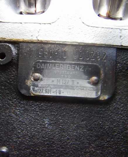

See my attachment for what the engine plate looks like.

Download Attachment: MB Engine Number.JPG

Thanks for the engine number pictures.
