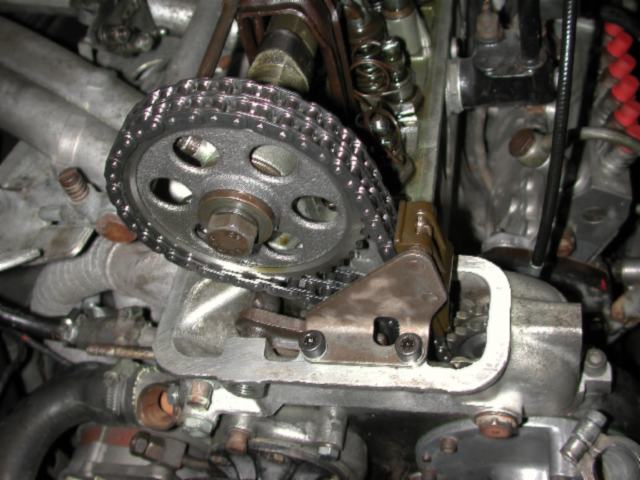

New sprockets, chain and plastic rail:
Download Attachment: TimGr_sprkt.JPG

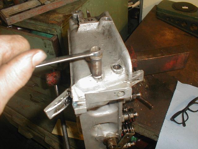

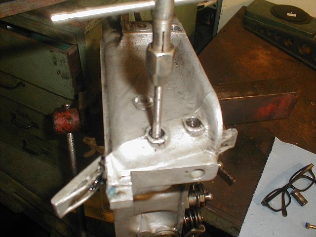

Don't be confused by the cylinder head. The pins and process is the same as in the block.
Clean the threads first as Dan mentioned.
Download Attachment: tap a.JPG
42.25 KB

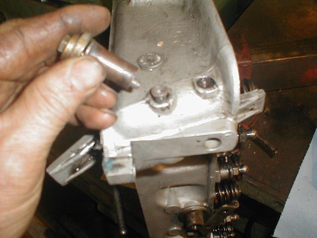

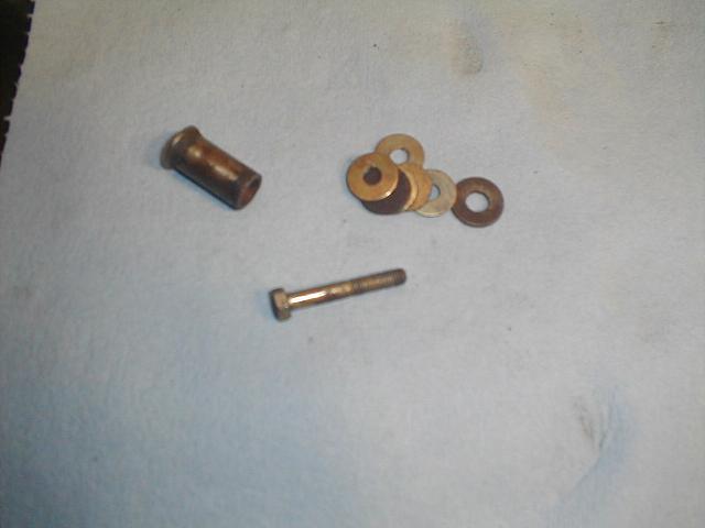

You can make a simple puller with a spacer and some washers. Make sure the spacer is big enough inside for the pin to pull into. Also use a grade 10g  or greater metric bolt.
Download Attachment: simple puller 1a.JPG
22.07 KB
 Download Attachment: sp1a.JPG
45.23 KB
Place the spacer over the pin and when you tighten down the bolt the pin will draw out.
You will have to add washers along the way when the bolt bottoms out in the pin.
Download Attachment: sp3a.JPG
37.83 KB
You will need to make sure that the bolt threads into the pin at least four turns before pulling begins. Pay attention when the bolt bottoms out so you can add washers and keep pulling.
