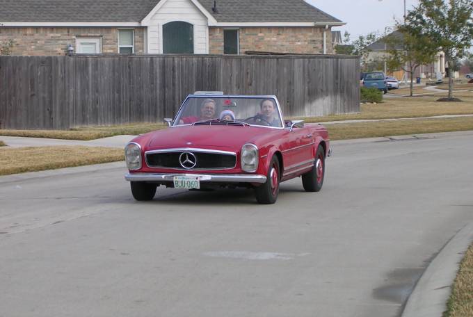

You guys nailed it. The filter was so plugged with crud that no fuel could get through.
This car had been off the road for five years and I cant tell you how happy we were to get it fixed up and running again.
we took the gas tank out and thoroughly cleaned inside and wire brushed it and painted it outside and painted up under where it goes and put it back in. we put new gas lines and cleaned the fuel pump and filter. The filter was unbelivably packed.We did a bunch of other work on the car too while we were at it.
Thank you again to everybody that offered advice. you were right on. PAT.

« Reply #6 on: December 31, 2005, 09:46:56 »
Hello Pat,
Great to see another W113 back on the road! Looks like a european delivery car with the euro headlights and no front bumper  overiders.
You may want to change the filter again soon just to make sure that the crud doesn't make it to the fuel injection system.
