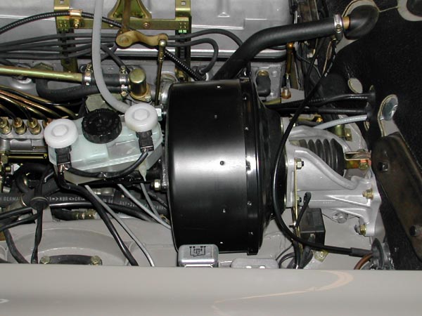

Re: Idle speed solenoid
« Reply #20 on: June 26, 2003, 06:45:46 »
Download Attachment: engine280closer.jpg
60.97 KB
Good morning!!!
I discovered I have an unconnected wire. It is tied up to the set of wires that are plugged to the engine bloc, on the right of the last spark plug (n. 6) see picture. 3 sets of wires go together...the one unplugged or unconnected has an round ending with a hole: it needs to be fixed by a nut....
WHERE DO I FIX IT BACK????
I am not a good mechanic and still learning, so pardon my ignorance...
Many thanks!
Fabrice
Silver 1971 280 SL
New York City
« Reply #22 on: June 26, 2003, 08:05:54 »
Rudy..
unfortunately it is not mine....but it is the only picture I found that could illustrate what I am talking about!!!!
This is from a concours level car sold recently for over 50k......
Silver 1971 280 SL
New York City
