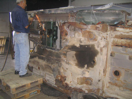

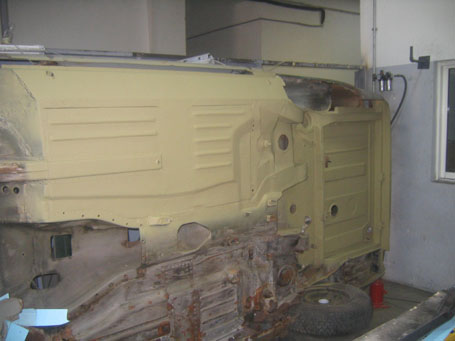

Following are two photos of the floor on a 280SL am restoring the whole floor and boot where changed
Good luck

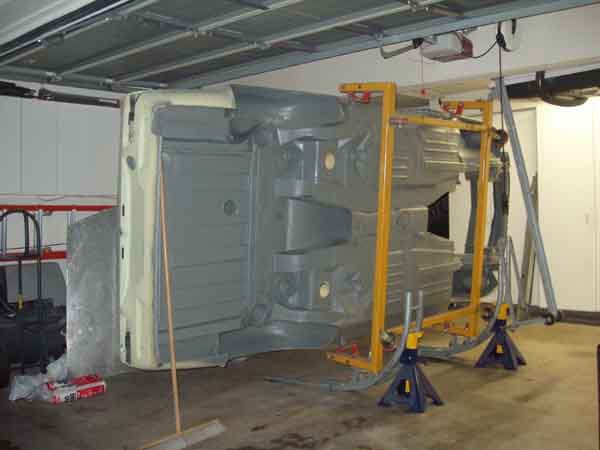

Re: Photos of a floor project?
« Reply #5 on: November 23, 2005, 12:47:06 »
Ok -- possibly a silly question: does replacing the floor pans always entail what I see in Mal's project -- turning car on side, removing nearly everything -- or is his the more extreme total restoration variety?

« Reply #6 on: November 23, 2005, 16:06:52 »
james,
     you need to have your head close enough to the welding gun to see the weld pool.  It is physically fatiguing to remain still and in a contorted position while delicately manouvering the gun.  If you are in really good shape you can do this without tiring, if not Mals set up is ideal.  Generally though if you can lift your car 3 ft off the ground you are in good shape to reach just about anywhere.
Im not sure what the forces on the shell are with certain panels missing, but the rotisserie is pretty cool and will certainly make for more comfortable and easier welding.

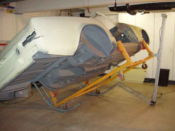

A floor restoration on a badly rust damaged W113 can take a professional shop 100 hours or more depending on the amount of fabrication and/or the pre-made panel used.
Having the right equipment and the car set up so it can be worked on easily will save time and improve quality. If you are not equipped or experienced the work will take a lot longer. If you are working on your back expect to spend a lot more time.
If you have a complete floor and chassis to rebuild, setting the car on its side with a fixture is well worth the effort in the long run. You will save an enormous amount of time and discomfort and the quality of the repairs will be better in most cases.
However I understand that this is beyond the capabilities of most owners.
If I am not setting the car on its side, I prefer to lift it from one side at a time. In this way not all the welding is done on your back!

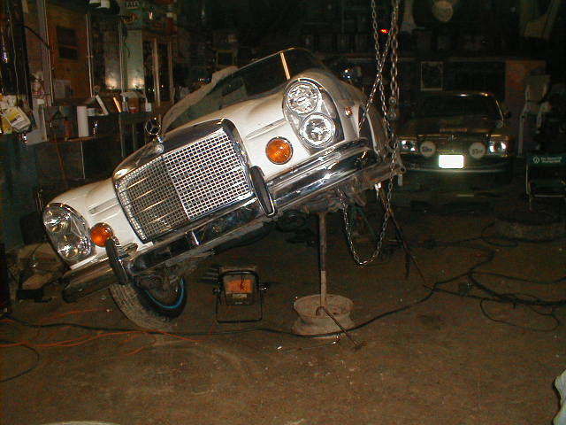

« Reply #15 on: December 03, 2005, 13:55:52 »
I used one, worked great. Although I used mine with a car stand, will make tough jobs enjoyable (ok, easier).
Worth it!

I believe Tom's pics show two variations of the same system.  The first looks like it uses wheel lugs to suspend the car.
The second pic shows the same overall setup but using a frame system to suspend the W113 usning its jack stand holes.  A word of caution if using this system.  The frame setup assumes the W113 rails are in good shape.  The bracket for my drivers side front jack stand pipe was very rusted.  The bracket and pipe are welded to the lower and larger frame rail. Looking back at it now I would not have wanted to use it to jack up the car to replace a flat tire.   Assuming you have major rust repairs to attend to I suggest some sort of inspection of the rails and jack stand brackets before tilting the uni-body.  In spection of the brackets can be accomplished by cutting away the bottom section of the frame rail or in the case of the front bracket you can cut away some of the firewall and look inside the frame rail to inspect the jack stand pipe brackets.
Tom230sl
« Reply #18 on: December 04, 2005, 19:19:54 »
Yes, good point. On a setup like I had, you must have good jack-mounts. The tilter is sold with mounting brackets that allow you to remove the wheels and lug nut on the mounting brackets. The good thing about the system is for relatively little money, you can get good access to the bottom of the car--even in a garage like mine.
