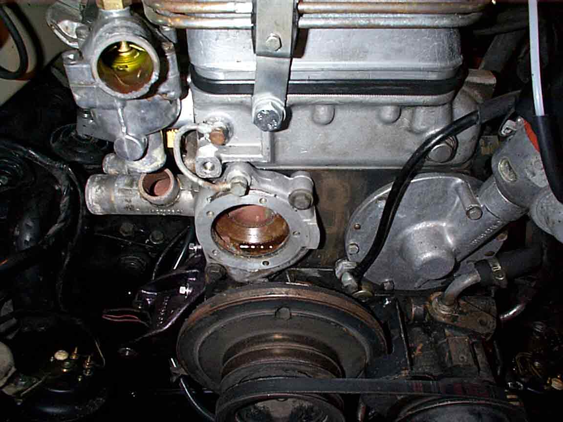

I am in the process of putting in a new water pump.  Take a look at the attached photo.
 :?: What does the number on the block represent?  Notice what appears to be a "9" between the water pump housing and the distributor...
[:0]It's a mystery???
Download Attachment: 113-Engine.jpg

Was the engine ever rebuilt or otherwise out of the car?
Re: Mystery Number?
« Reply #2 on: November 20, 2005, 05:58:52 »
Hi Cees,
I dont have any record of my engine being out of the car and/or rebuilt.  The serial number of the engine does match the data card, so it's still the original engine.

Oh yeah  - - - that Beatles song was on the "white album" was it not?
Hey Bob,  I would do three things before you go much further 1) wipe some typists White-Out into the degree marks on the vibration dampner  2)  if you have not already done so, clear the crud out of the horse-shoe coolant bypass tube ( mine was completely plugged ) and 3) install that angled coolant hose at the base of the thermostat housing before you paste up the gasket. Also - -  I believe the bolt that secures the camchain idler gear shaft has a prescribed  torque value.  Anxious to get it started aren't you?

Hi Larry,
Thanks for your suggestions.  I ordered a new small bypass tube (with bleed screws) when I ordered the new water pump.  I agree, I bet it's full of crud!  I havent removed my old one yet.  Want to wait for the new one to arrive first.  Also agree about putting on the short hose between the thermo and thermo housing before putting on the new pump and gasket.  I am sure it will be a bear to put the new one on.  I will use a bit of silcon spray to hopefully make it slip on easier.
Thanks again!
