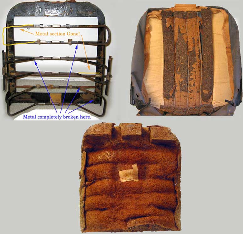

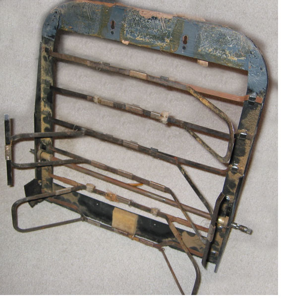

My driver's seat was sagging as well, plus it felt as if something was poking me in the back. The M-B Tex didn't look too bad from the outside so I decided it probably just needed a few new horsehair pads and I'd be set to go.
The seat came apart easily enough thanks to all of the descriptive posts I'd read here. Once I pulled off the original cushions I was in for the real surprise. The back frame had no less than 4 of the supports broken AND several large pieces completely missing. The bottom frame was not much better with one poorly repaired broken spring and two overly stretched & sagging ones.
The Back Frame is a basket case and isn't even worth trying to weld. Since the few pieces left that weren't broken had to handle the full weight, they are fatigued and on the verge of failure. The horsehair is falling apart due in part to the missing support pieces as well. The backside of the M-B Tex material looks pretty tired so I won't be using these again.
OK.....my quick re-padding of the seats has turned into quite the adventure. I figure that my best bet at this point is to find another decent seat for a late 280SL, unless someone knows of a reasonable source for both frames.
